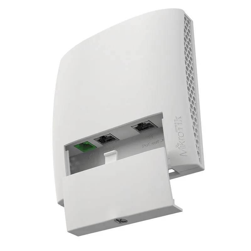

wsAP ac lite (RBwsAP-5Hac2nD)​
The wsAP is a wall socket wireless access point. It is already configured, you can simply connect the Internet cable and start using wireless Internet. We recommend you to set up a password to secure your device. See the wsAP ac lite product page for full specifications and brochures. As with any MikroTik wireless access point, you can also manage it using the CAPsMAN wireless access point management server. In this case, all configuration will be done in CAPsMAN. See Buttons and jumpers on how to set this device as a managed CAP.

Mounting​
The device should be mounted on standard electrical wall boxes, where ethernet cabling has already been installed. The included mounting plate fits most worldwide wall box standards. Orient the wall mounting plate on top of your wall box, and install the screws that fit your wall box screw holes the best. Once the plate is in place, plug the required cables into the wsAP unit, and mount the unit on the mounting plate by putting it on the mounting hooks and slightly pulling it downward, to secure in place.
Powering​
The device only accepts powering at the E1 port with PoE, so you must either a passive PoE injector (not included), or make sure your switch supports passive or 802.3af/at PoE output. The power consumption under maximum load can reach 8 W.

Extension slots and ports​
  • Three RJ45 ethernet ports that support automatic cross/straight cable correction (Auto MDI/X), so you can use either straight or cross-over cables for connecting to other network devices. The E3 port is capable of powering another RouterBOARD device with passive and 802.3af/at PoE. The maximum output current is 500 mA when using less than 30 V to power this device and 420 mA when using more than 30 V.
  • Two directly linked (passthrough) RJ11 ports.
  • One USB type A connector with max 0.5 A output at 5 V.
  • The integrated wireless module which supports AP/CPE/P2P/Repeater modes.
