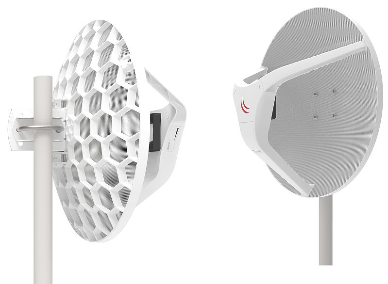

Wireless Wire Dish (RBLHGG-60adkit)​
The Wireless Wire Dish is a set of two LHG 60G devices that work in the 60 GHz wireless spectrum. Factory configured in pairs for an easy first start.

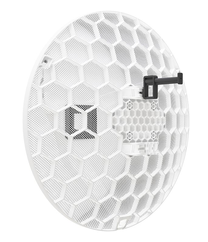

  • Attach the two legs to the LHG case.
  • Snap the assembled LHG unit to the grid in the appropriate locations.
  • Fix the legs in place with two self thread screws (Use Phillips screwdriver PH2).

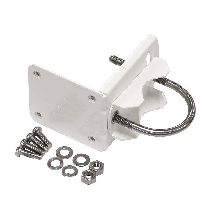

  • Attach the mounting assembly to the back of the device with four provided screws.
  • Mount the assembled unit to the pole using the provided U bolt clamp. The clamping diameter with the provided steel clamp is 35 – 70 mm.
The device includes a grounding connection (marked ⏚) which you should connect to the grounding installation of the tower or building where the device will be used. This is to substantially reduce the risk of ESD and lightning damage. Grounding connector included in the package.

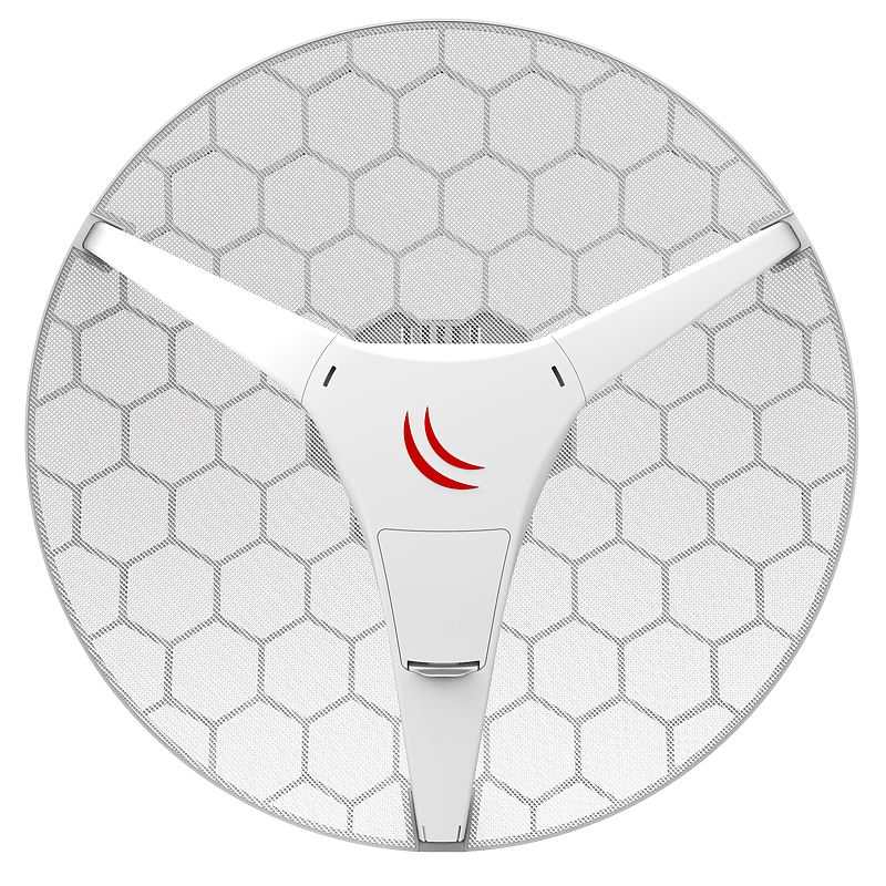

LED status​
The device includes precise alignment guides using LEDs. The lights indicate with arrows direction to turn the dish if looking from behind the dish to the other end of the link. When alignment LEDs turn off, leaving only the "link established" LED, it means alignment is complete. The LED lights are:
  • Tilt-up.
  • Tilt down.
  • Rotate to right.
  • Rotate to left.
  • LED on when the link established.
  • LED on when Ethernet connected.
  • User-configurable LED.
  • Power state on.
