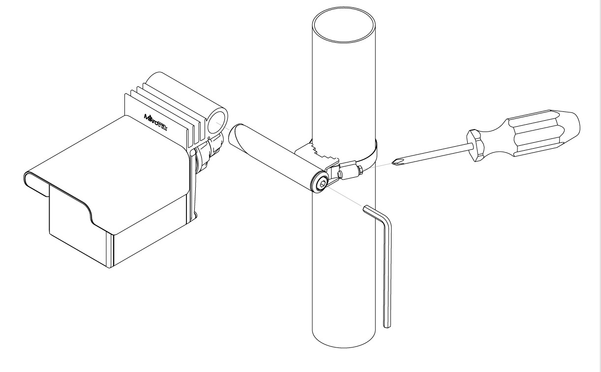

Assembly and mounting
The device can be mounted on a vertical or horizontal pole. The maximum pole diameter is 51 mm.
Mounting and configuration of this device should be done by a certified person.
Choose your desired position, the device will require precise adjustment for best performance.
- Attach provided mount to the mast and secure with a screwdriver.
- Attach the device to the mounting bracket and secure using provided tool.

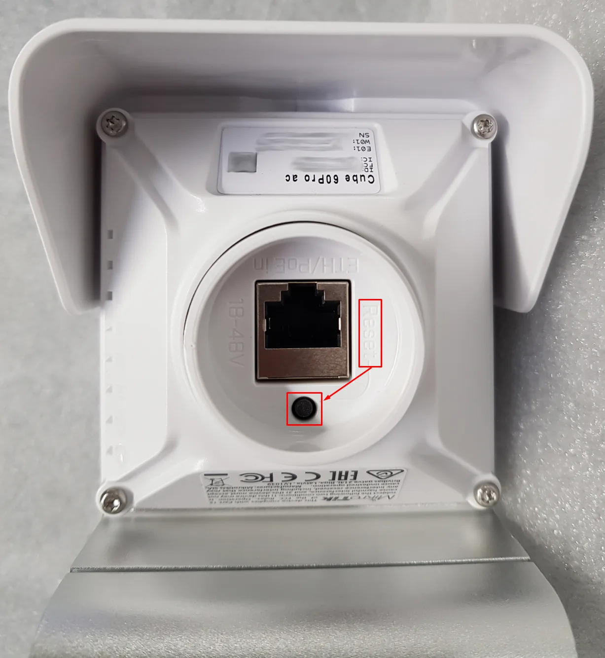

Reset button
The routerBOOT reset button has the following functions. Press the button and apply the power, then:
- Release the button when green LED starts flashing, to reset RouterOS configuration to defaults.
- Release the button when the LED turns solid green to clear all configuration and defaults.
- Release the button after LED is no longer lit (~20 seconds) to cause the device to look for Netinstall servers (required for reinstalling RouterOS over the network). Regardless of the above option used, the system will load the backup RouterBOOT loader if the button is pressed before power is applied to the device. Useful for RouterBOOT debugging and recovery.

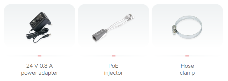

The package includes the following accessories that come with the device:
