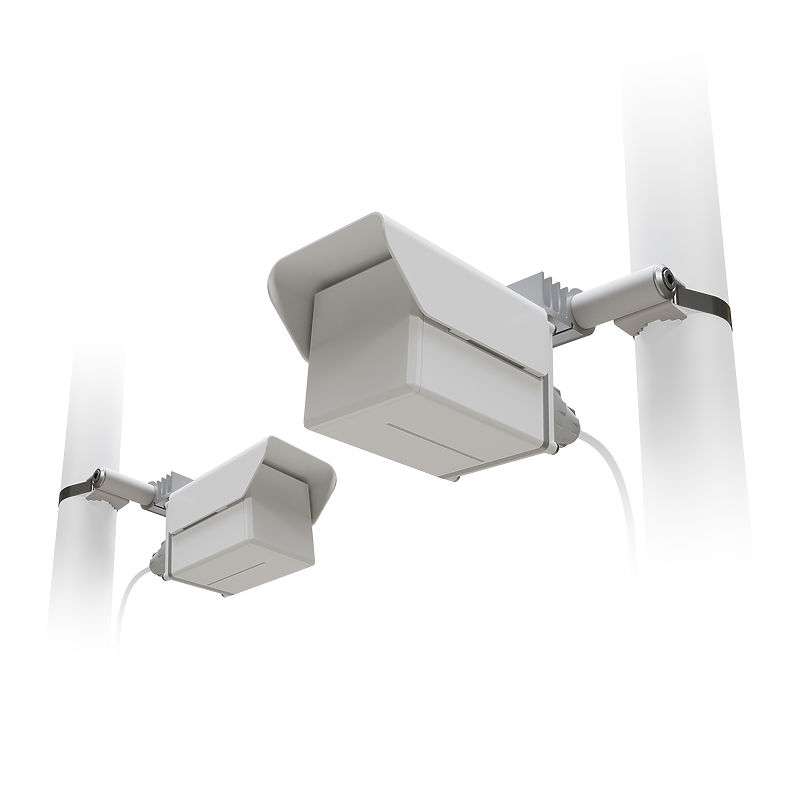

The device can be mounted on the vertical or horizontal pole as shown in pictures A and B. Please note that a device needs to be mounted with the bottom latch facing down. The maximum pole diameter is 51 mm.
Mounting and configuration of this device should be done by a certified person.
Choose your desired position, the device will require precise adjustment for best performance.
  • Attach provided mount to the back of the device with provided screws using a ph0 screwdriver.
  • Mount on pole with U bolt bracket using 8 mm ratchet.
  • Place a bolt in one of the three positions, they will allow for fine adjustment, when placed in the middle you can adjust in a 23-degree range if an adjustment needs to go further replace the screw in a different position.
The IP rating scale for this device is IP54. When mounting outdoors, please ensure that any cable openings are directed downwards. We recommend using the POE injector and proper grounding with Cat6 shielded cable. When using and installing this device please pay attention to Maximum Permissible Exposure (MPE) safety distance with a minimum of 20 cm between the radiator and your body.
Alternatively, the device can be mounted on one of the three mounting slots on the backside of the device.
  • You can use a metal ring for example.
  • Use a Phillips screwdriver to loosen the metal ring.
  • Slide one end of it through the most convenient of the three mounting slots.
  • Position the device on the pole where it will be mounted.
  • Slide the loose end of the mounting ring back to its closing latch and use the screwdriver to tighten it.
It's recommended to secure Ethernet cable to the pole using zip ties. With the distance from the device approximately 30 cm.
As an additional option, you can use "quickMOUNT-X" – mounting bracket for an easy adjustment that can be obtained separately. Product web page: https://mikrotik.com/product/qm_x
Specially designed enables vertical and horizontal adjustment on the pole.
