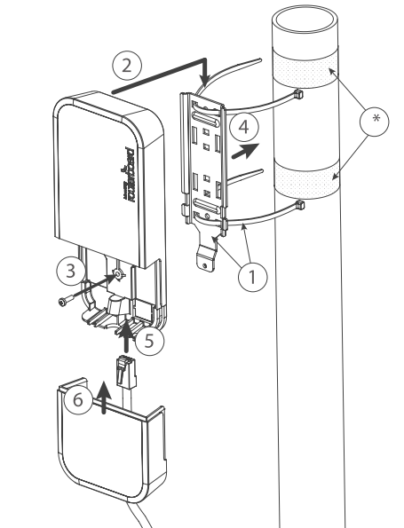

Mounting on the mast or pole:
** It's recommended to use electrical tape to increase friction between materials.*
  • Mount plastic tie straps to steel bracket guiding them through holes.
  • Mount bracket to the device.
  • Secure them with a screw.
  • Mount and align the device on the pole or mast.
  • Guide Ethernet cable through the opening and connect to the Ethernet port.
  • Close bottom latch and secure with a screw. It's recommended to secure Ethernet cable to the pole using zip ties. With the distance from the device approximately 30 cm.

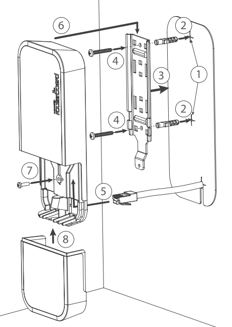

Mounting unit on the wall:
  • Use included a template to mark spots for drilling holes. And if needed for Ethernet cable. Align accordingly, it will depend on how the device will be mounted finally.
  • Insert dowels if needed, depends on wall structure and material.
  • Place included a steel bracket on the wall.
  • Use screws to secure it in the place.
  • Extend your Ethernet cable through the opening and connect to the Ethernet port.
  • Mount the device on the steel bracket
  • Secure it in place with the screw.
  • Close bottom latch. Avoid mounting the device on the low ground spot, as you won't be able to attach and close the bottom latch.

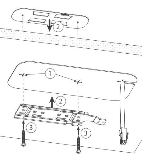

Mounting on the ceiling:
A Special bracket is included in the package to mount on the drop ceiling. As it consists of two parts, to be attached on both sides of the ceiling tile.
  • Use the template to mark spots for holes.
  • Place both mounting brackets on the spot.
  • Secure them together using screws. Continue assembling in the same manner if mounting on the wall.
  • Mount the device on the steel bracket.
  • Close bottom latch. 150

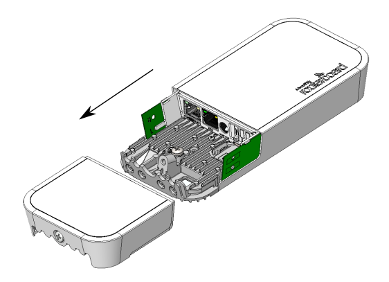

Bottom Lid​
  • The bottom lid is secured in place with the captive screw.
  • Use the Philips PH2 screwdriver to unscrew it, but do not remove the screw completely.
  • Pull the cover in the opposite direction from the device to remove it.
  • Reassemble.
