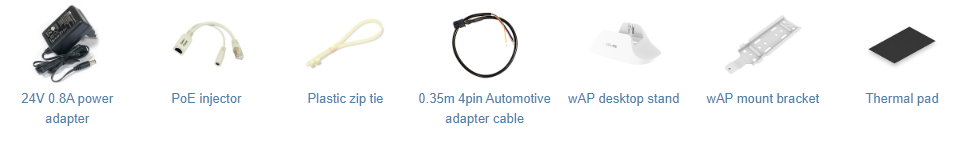

Package includes the following accessories that come with the device:
