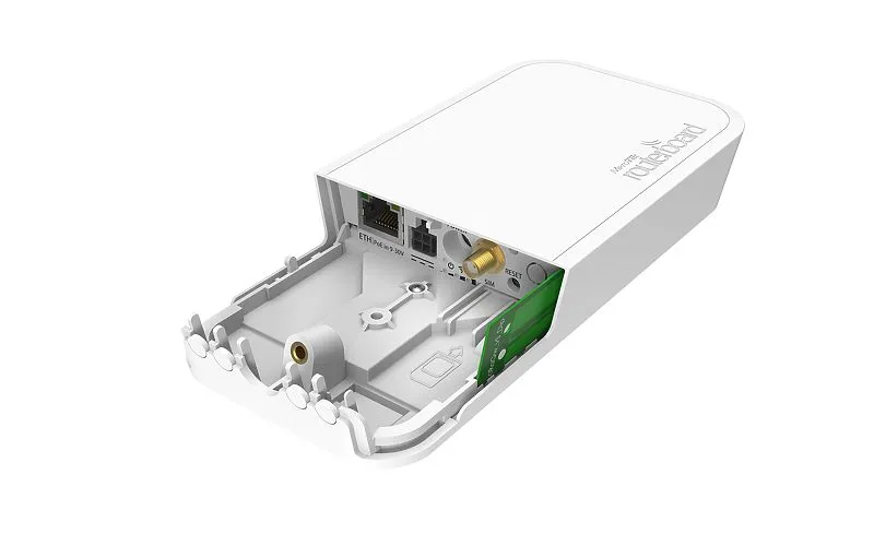

Extension slots and ports​
  • 10/100 Ethernet port, supporting automatic cross/straight cable correction (Auto MDI/X). Either straight or crossover cable can be used for connecting to other network devices.
  • External SMA antenna connector already connected to the LR card.
  • LED indicating a power state of the device.
  • LED Indicating the activity of Wireless network.
  • Automotive connector. Pinout: A - reserved for future use (orange), B - reserved for future use (blue), C - ground (black), D – power in (red).
  • MiniPCIe slot with integrated LR9 card.
  • Integrated Wireless module operating at 2.4 GHz, 802.11b/g/n protocol.
  • SIM slot.

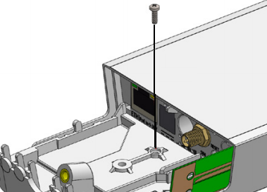

Bottom Lid​
  • The bottom lid is secured in place with the captive screw.
  • Use Torx T20 screwdriver to unscrew it, but do not remove the screw completely.
  • Pull the cover in the opposite direction from the device to remove it.
  • Reassemble.

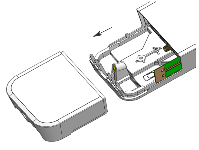

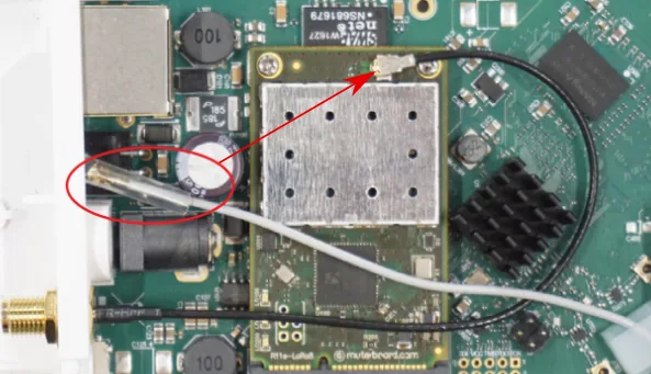

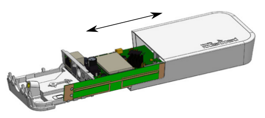

Internal antenna 2 dBi can be used for setups where the distance to the gateway are closer than 1km. By default, the antenna is not connected to the card! To use an internal antenna:
  • Open bottom door (see "").
  • Use PH2 screwdriver to remove the screw.
  • Disassemble upper case from the bottom by sliding them to opposite sides.
  • Locate internal antenna cable and replace it with the SMA cable connector on the LR card.
  • Reassembly.
