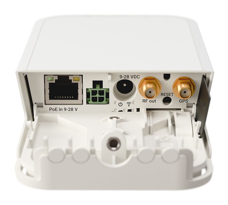

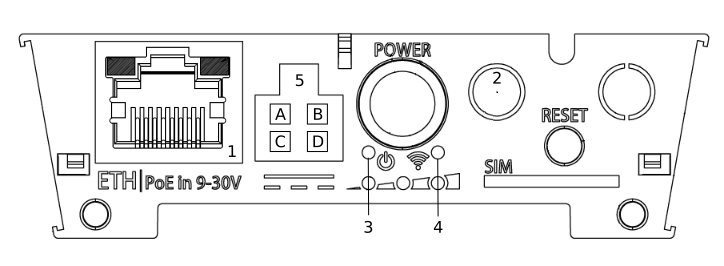

Extension slots and ports​
  • 10/100 Ethernet port, supporting automatic cross/straight cable correction (Auto MDI/X). Either straight or crossover cable can be used for connecting to other network devices.
  • External SMA antenna connector already connected to the LR8G card that is used for LoRa frequencies.
  • External SMA antenna connector already connected to the LR8G card that is used for GPS reception.
  • LED indicating the power state of the device.
  • LED Indicating the activity of the Wireless network.
  • Automotive connector. Pinout: A - reserved for future use (orange), B - reserved for future use (blue), C - ground (black), D – power in (red).
  • MiniPCIe slot with an integrated LR8G card.
  • Integrated Wireless module operating at 2.4 GHz, 802.11b/g/n protocol.
  • SIM Slot.
Powering​
The device accepts power in the following ways:
  • The Ethernet port accepts passive PoE 9-28 V DC ⎓.
  • Direct-input power jack (5.5 mm outside and 2 mm inside, female, pin-positive plug) accepts 9-28 V DC⎓.
  • Automotive connector 12-30 V DC⎓. The power consumption under maximum load can reach 7 W.

The device can be mounted in several ways: pole, wall, ceiling or it can be placed in a specially designed MikroTik holder which comes with the package. The package also includes a drill hole template with detailed mounting instructions, to help you with the Ethernet cable installation and attachment to a ceiling or a wall. Steel bracket to put on the other side of a dropdown ceiling tile and two screws and wall anchors. Zip ties or steel clamps for mounting on the pole.
The IP rating scale for this device is IP54. When mounting outdoors, please ensure that any cable openings are directed downwards. We recommend using the POE injector and proper grounding with Cat6 shielded cable. When using and installing this device please pay attention to Maximum Permissible Exposure (MPE) safety distance with a minimum of 20 cm between the radiator and your body.
Mounting on the mast or pole:
It's recommended to use electrical tape to increase friction between materials.
  • Mount plastic tie straps to steel bracket guiding them through holes.
  • Mount the bracket to the device.
  • Secure them with a screw.
  • Mount and align the device on the pole or mast.
  • Guide the Ethernet cable through the opening and connect it to the Ethernet port.
  • Close the bottom latch and secure it with a screw.

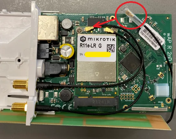

Antenna usage​
We recommend using an external antenna, which can be obtained separately, like our "LoRa omni antenna". The antenna has a pole mount and cable ready to use with LR cards - https://mikrotik.com/product/868_omni_antenna The SMA connector located under the bottom door is already connected to the LR card and ready to be used. Please see the section on how to remove the door.
Please connect and disconnect the antenna, when the device is turned off!
Internal antenna 2 dBi can be used for setups where the distance to the gateway is closer than 1km. By default, the antenna is not connected to the card! To use an internal antenna:
  • Open the bottom door (see "").
  • Use the PH2 screwdriver to remove the screw.
  • Disassemble the upper case from the bottom by sliding them to opposite sides.
  • Locate the internal antenna cable and attach it to the LR card (connector labeled "RFIO"):
  • The other connector (labeled "GPS"), is used for connecting GPS antennas.
  • Reassembly.
