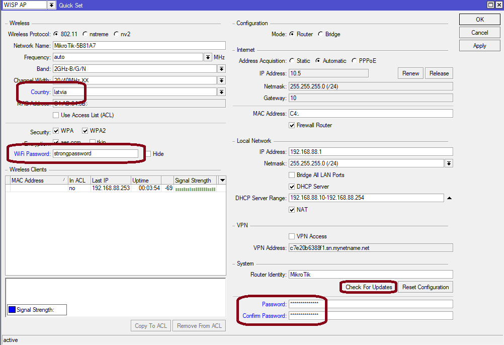

  • Click the "Check for updates" button and update your RouterOS software to the latest version, the device needs to have an active Internet connection.
  • After the update set your country, to apply country regulation settings.
  • Set your WiFi password.
  • Set the router password.

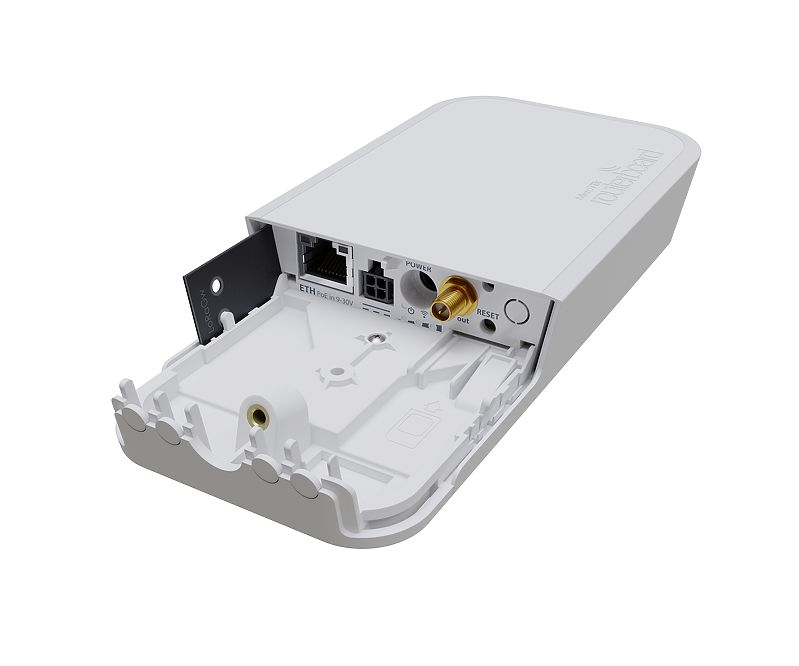

  • 10/100 Ethernet port, supporting automatic cross/straight cable correction (Auto MDI/X). Either straight or crossover cable can be used for connecting to other network devices.
  • External SMA antenna connector is already connected to the LR card.
  • Automotive connector. Pinout: A - reserved for future use (orange), B - reserved for future use (blue), C - ground (black), D – power in (red).
  • MiniPCIe slot with an integrated LR2 card.
  • Integrated Wireless module operating at 2.4 GHz, 802.11b/g/n protocol.
  • Mini-SIM Slot.

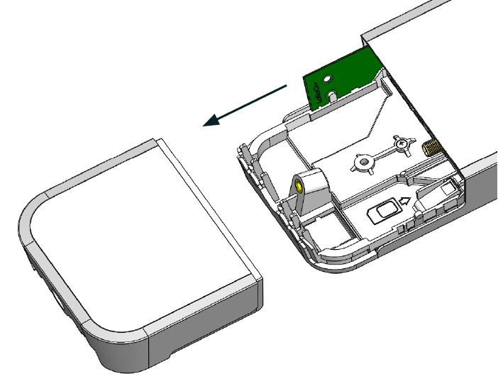

Bottom Lid​

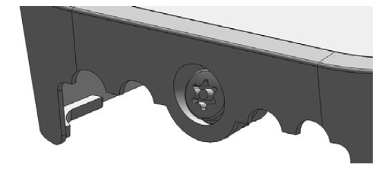

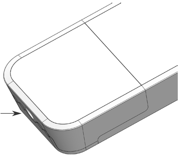

  • The bottom lid is secured in place with the captive screw.
  • Use a Torx T20 screwdriver to unscrew it, but do not remove the screw completely.
  • Pull the cover in the opposite direction from the device to remove it.
  • Reassemble.

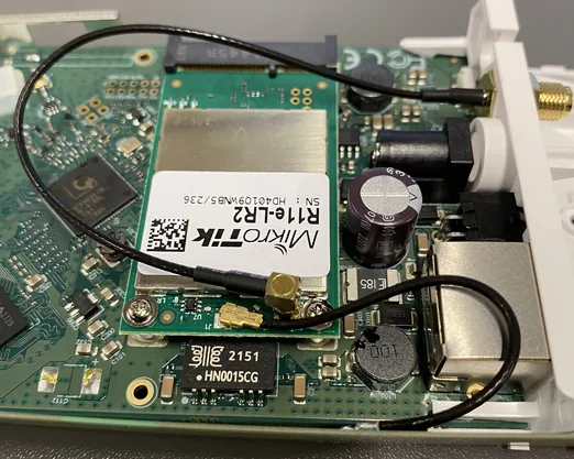

Antenna usage​

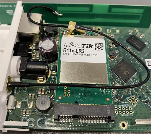

We recommend using an external antenna, the "TOF-2400-8V-4" - which can be obtained separately. The antenna has a pole mount and cable ready to use with LR cards. https://mikrotik.com/product/tof_2400_8v_4 SMA connector located under the bottom door is already connected to the LR card and ready to be used. Please see the section on how to remove the door.
There is no need to disasemble the device. The installed LR2 mini PCIe card has two connectors available - uFL and MMCX. The internal antenna is attached via a uFL connecter and is ready to be used from the get-go. MMCX connector is already attached to the SMA and if you wish to use an external antenna, just connect it to the SMA. The device will choose which antenna to use based on the setting that will be shown later.
Please connect and disconnect the antenna, when the device is turned off!
Internal antenna 4.7dBi can be used for setups, where the distance between the node and the device is up to 200 meters (the actual distance needs to be checked in the environment). This antenna is attached and ready to be used.

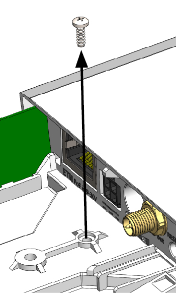

To confirm how the antennas are attached:
  • Open the bottom door (see "").
  • Use the PH2 screwdriver to remove the screw.

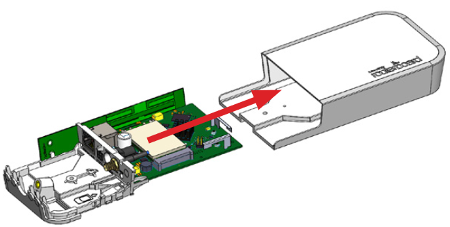

  • Disassemble the upper case from the bottom by sliding them to opposite sides.
  • An internal antenna will use the uFL connector and SMA (for the external antenna) will be connected via the MMCX connector as per the pictures below.
  • Reassembly. The software is responsible for selecting the antenna used by the device.
Make sure that the right connector is used by the module in the software settings.
In order to do that, go to the device's GUI and check which connector is used under *LoRa → Devices → "Double-click" on the gateway → Under the "Antenna" section:
If you wish to use an internal antenna, leave uFL selected. If you wish to use an external antenna that is connected to the SMA slot, select MMCX.
