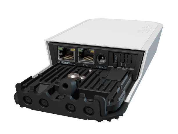

  • The bottom lid is secured in place with the captive screw.
  • Use the Philips PH2 screwdriver to unscrew it, but do not remove the screw completely.
  • Pull the cover in the opposite direction from the device to remove it.
  • Reassemble.
Powering​
The device accepts power from the power jack or from the Ethernet port, both provided in the package:
  • Direct-input power jack (5.5 mm outside and 2 mm inside, female, pin positive plug) accepts 12-57 V ⎓ DC;
  • Ethernet port accepts 802.3af/at PoE 18-57 V ⎓ DC.
The power consumption under maximum load can reach 9 W. Please attach ground (earth) wire to the screw under the bottom lid.

Buttons and jumpers​
The reset button has three functions:
  • Hold this button during boot time until the green LED light starts flashing, release the button to reset RouterOS configuration.
  • Keep holding the reset button until the LED turns solid, then release it to enable CAP mode. The device will then start searching for a CAPsMAN server.
  • To reinstall RouterOS using the Netinstall utility, enter the device into BOOTP mode. Two booter options are available: the Regular Booter and the Backup Booter. It is recommended to verify both options in case one does not work.
    • Regular Booter: To enter etherboot mode, press the Reset button after powering on the device and waiting 1–2 seconds.
    • Backup Booter: Power off the device. Press and hold the Reset button, then power on the device. Wait for the LED sequence (blinking → steady → off), then release the button. The device will boot into BOOTP mode, ready for RouterOS reinstallation via Netinstall. Depending on the model, this may be indicated by the USR, USER, System, or ACT LED, or by the SFP port LED.
Regardless of the above option used, the system will load the backup RouterBOOT loader if the button is pressed before power is applied to the device. Useful for RouterBOOT debugging and recovery.
