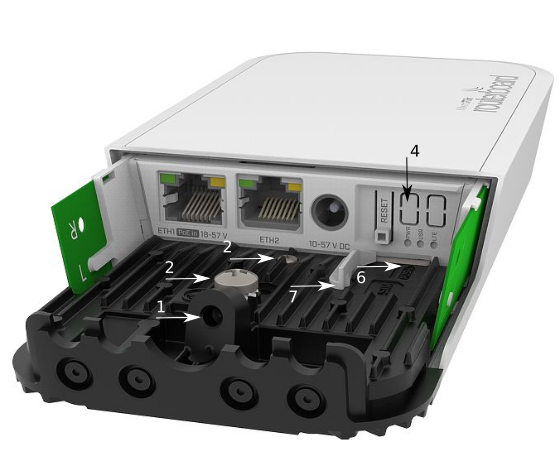

The device is equipped with a miniPCIe slot with a factory-installed LTE6, LTE, or 4G card. A SIM slot is provided for use together with a miniPCIe modem. The SIM slot is not used separately. In addition, you can install external antennas of your choice, this should be done by a qualified person, follow safety precautions when handling electrical equipment, use a wrist grounding strap when unpacking, and working with electrical components to avoid electrical discharge (ESD) damage. To install the external antennas:
  • Remove the screw using Philips PH2 screwdriver and slide down the bottom lid to remove it;
  • Remove both screws below the power jack and slide out the wAP PCB board;
  • Disconnect the grey uFL connector from the MAIN antenna connector of the modem, disconnect the black cable from the other (or AUX) connector;
  • Remove two plastic doors using a flat screwdriver or similar tool and feed antenna wires through the holes and connect to the LTE6 card installed;
  • After you have reinserted the wAP board into the case and secured it with the screw that was removed earlier;
  • Slide in the SIM card from your mobile operator into the SIM slot, with the chip facing up.
  • The SIM slot protects the SIM card from falling out with a plastic latch. You can press the latch to the left side to unlock and then insert the SIM card or replacing it using tweezers or a similar tool. When using external antennas, attach connectors to the case:

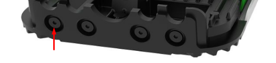

  • Make openings and use a 6.5 mm drill bit, and drill in any of four pre-designed spots;
  • Guide your ACSMAUFL connectors and secure them in place, see the picture below for reference on how to place rubber seals for best water protection:

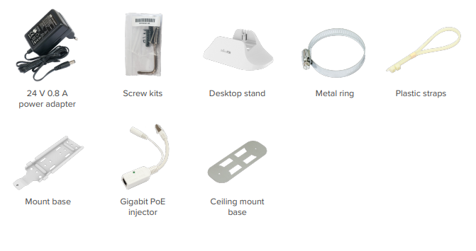

The package includes the following accessories that come with the device:
