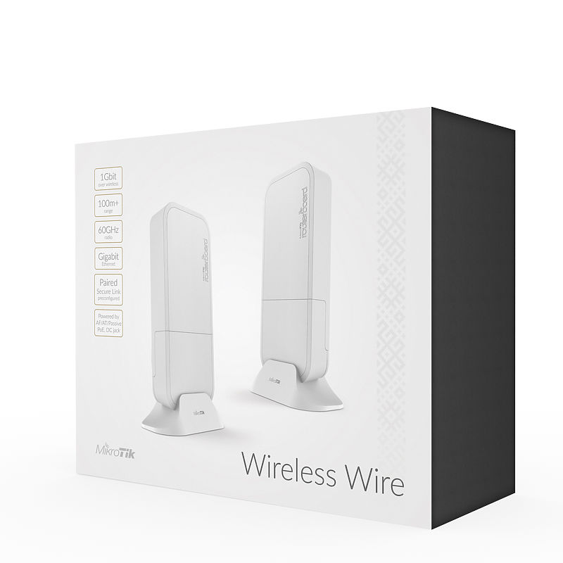

  • wAP60G AP units come pre-configured with WISP Bridge default configuration;
  • Wireless Wire and wAP60G units come pre-configured with PTP Bridge default configuration;
  • Wireless Wire devices have already, randomly generated, matching SSID, and Wireless passwords.

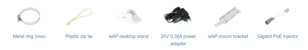

Included items​
