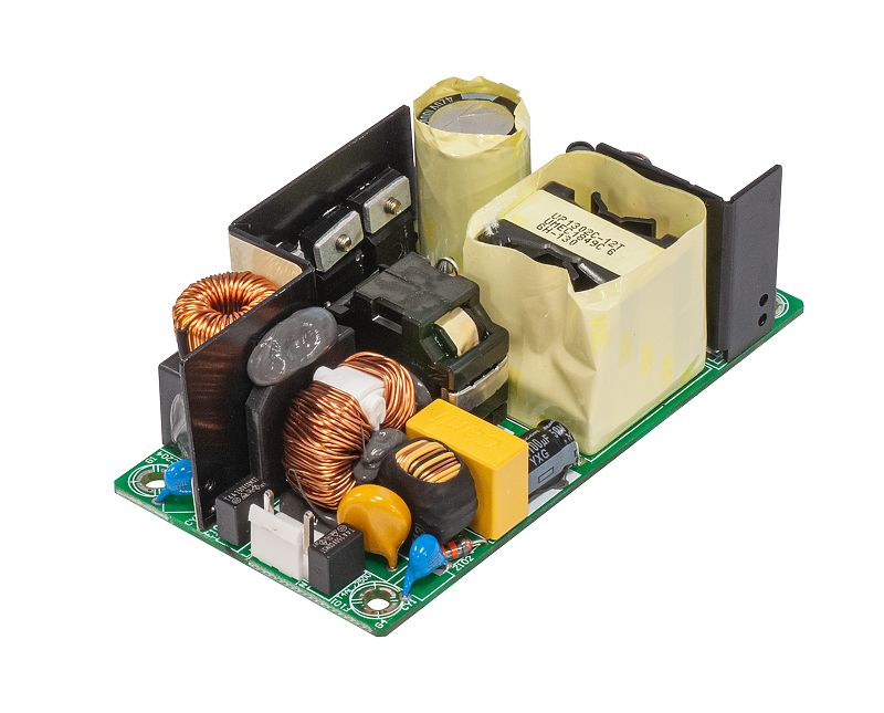

12V 10.8A internal power supply for CCR1036 series. See the UP1302C-12 product page for full specifications and brochures.
UP1302C-12 internal power supply.
Specifications​
Open frame PSU 12 V DC ⎓ 10.8 A 130 W, 90-264 Vac 90 % 55x106x34 mm.
Installing​
Each of the units comes in ESD protective packaging. Installing should be done by a qualified person, please follow safety precautions when handling electrical equipment:
  • Use a wrist grounding strap when unpacking and working with electrical components to avoid electrical discharge (ESD) damage;
  • Remove the top cover from the device to access the power supply unit;
  • Unplug wires from the supply unit leading to PCB;
  • Unscrew four screws and remove the old unit;
  • Place UP1302C-12 into the device and secure it with previously removed screws;
  • Attach the supply cable to the white connector;
  • Install to cover into its original position and secure with screws.
