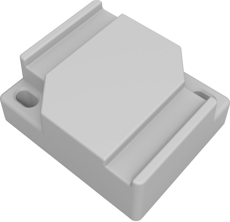

TG-BT5-OUT are ready to use Bluetooth Tag with a preinstalled battery. The software manual you can find under each product in the Support and Downloads sections https://mikrotik.com/products. See the TG-BT5-OUT product page for full specifications and brochures.

Outdoor Water Proof IP69k - TG-BT5-OUT
- Completely sealed and cast IP69k.
- Temperature range -20..+85°C.
- Shock absorbing case.
- Built-in 550mAh LiMnO2 battery.
- Suitable for strapping.
- Built-in temperature sensor.
- Built-in accelerometer.
- Magnet activation.
- NFC [Serial number].
- CryptoAuthentication [ATECC608A].
- Dimensions 38x32x15mm.
- BLE 5.2 with Silabs BG22.

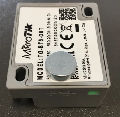

Configuration mode can be entered only from advertising mode by applying a magnet to the same switch icon as in the exiting factory sleep procedure. After applying a magnet for 5-10 seconds LED will turn off and the tag enters configuration mode. If you apply a magnet for longer than 15 seconds or won't connect to the tag with the configuration app, it will go back into advertising mode.

The magnet is used on the reed switch to change the tag's operating modes as described above. As soon as the magnet is detected (the reed switch is activated), the LED will start flashing for the next 5 seconds (first 5 seconds) and, then, stop. It can help you identify that 5 seconds have passed and that you can remove the magnet to enter configuration mode.

To "wake up" the tag from the factory sleep mode, the reed switch should be activated for 3-10 seconds.
- As soon as the device "wakes up", it will show up in the "MikroTik Beacon Manager" list. Select the tag and you can begin configuring it by pressing the "CONFIG ONLY" button:
- Right after that, you will need to put a magnet over the device for 10 seconds (this is the step where the device is set to the configuration mode):

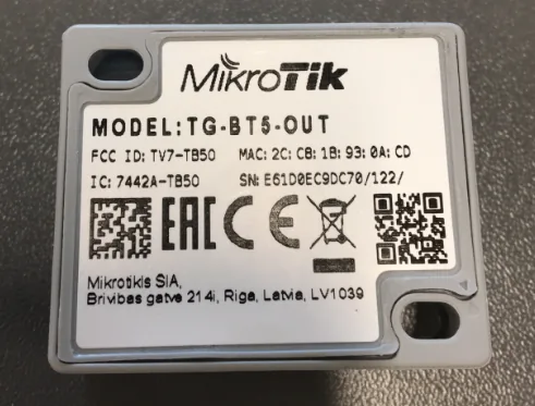

Federal Communication Commission Interference Statement
| Model | FCC ID |
| TG-BT5-OUT | TV7-TB5O |

| Model | IC |
| TG-BT5-OUT | 7442A-TB5O |
