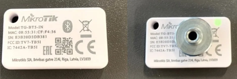

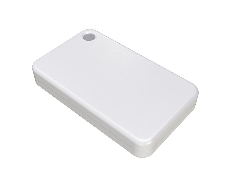

Indoor slim rectangular shape - TG-BT5-IN
- Temperature range -20..+60°C.
- Built-in accelerometer.
- Magnet activation.
- Dimensions 35x22x7mm.
- BLE 5.2 with Silabs BG22.
- Weatherproof (sealed) version with a built-in non-replaceable LiMnO2 CR2032 (220mAh) battery.

Configuration mode can be entered only from advertising mode by applying a magnet to the magnetic switch as in the exiting factory sleep procedure. After applying a magnet for 5-10 seconds LED will turn off and the tag enters configuration mode. If you apply a magnet for longer than 15 seconds or won't connect to the tag with the configuration app, it will go back into advertising mode.

The magnet is used on the reed switch to change the tag's operating modes as described above. As soon as the magnet is detected (the reed switch is activated), the LED will start flashing for the next 5 seconds (first 5 seconds) and, then, stop. It can help you identify that 5 seconds have passed and that you can remove the magnet to enter configuration mode.

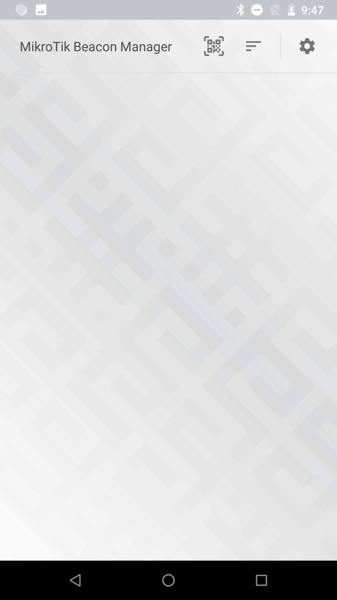

Install the "MikroTik Beacon Manager" application and run the app.
For Android devices, you can find it following the link.

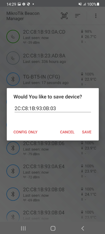

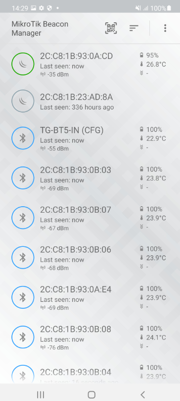

- Upon the first login, you will see the list of the nearby devices (devices in either advertising mode or configuration mode):
To "wake up" the tag from the factory sleep mode, the reed switch should be activated for 3-10 seconds.
- As soon as the device "wakes up", it will show up in the "MikroTik Beacon Manager" list. Select the tag and you can begin configuring it by pressing the "CONFIG ONLY" button:

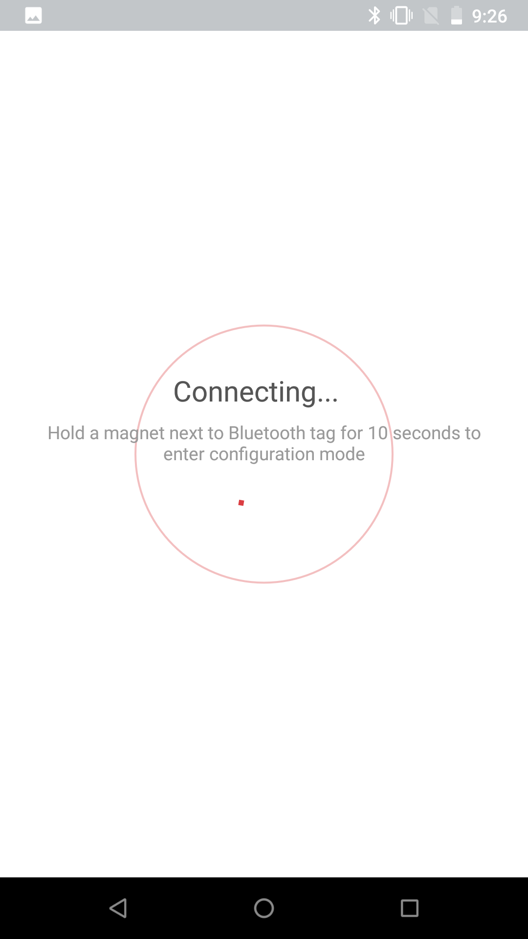

- Right after that, you will need to put a magnet over the device for 10 seconds (this is the step where the device is set to the configuration mode):

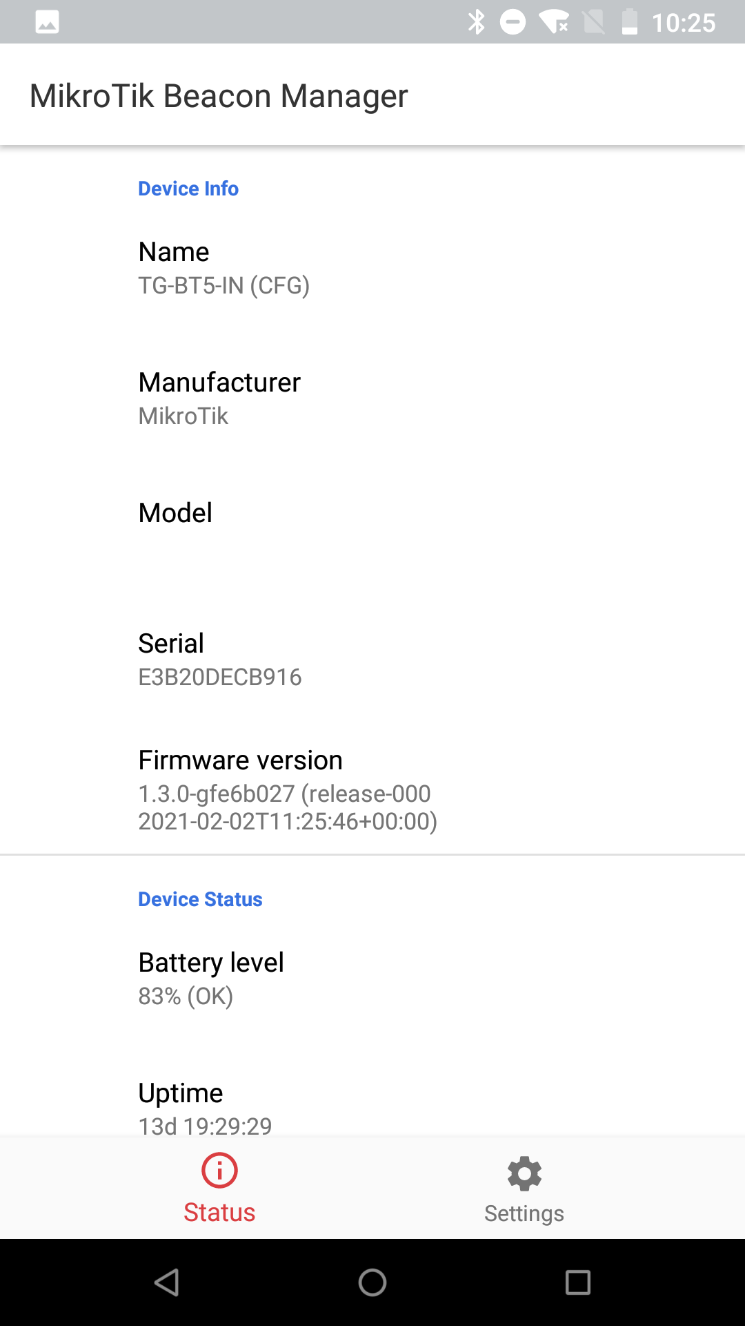

- After a short wind up time, the device should be ready to be configured:
The app will show general information about the tag in the "Status" tab and will allow you to alter the tag's setting using the "Settings" tab (as shown in the screenshot above).
