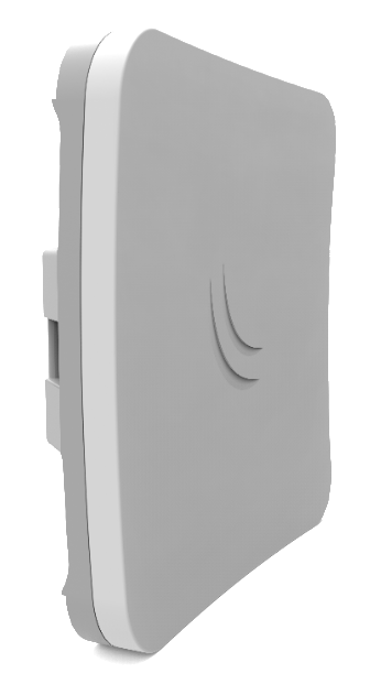

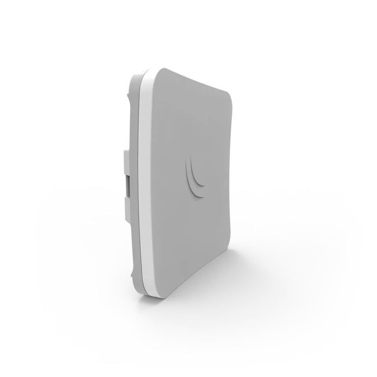

SXTsq-series
SXTsq Lite5
SXTsq 5 High Power (RBSXTsq5HPnD)​
The SXTsq is an outdoor wireless router with a built-in directional antenna. It can be used as a CPE or for point to point links (use RouterOS wireless mode "bridge" to work as a single-client AP for point to point scenarios). List of products in series: SXTsq Lite2 SXTsq Lite5 SXTsq 5 ac SXTsq 5 High Power
