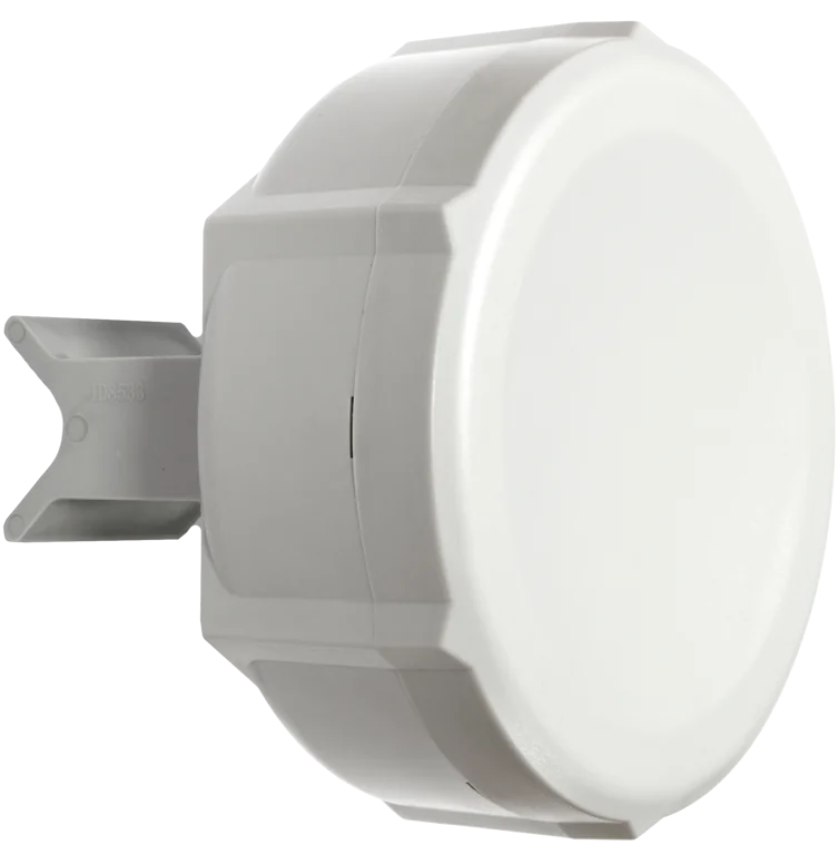

SXTsq 5 ac (RBSXTsqG-5acD)​
SXT series: SXT SA5, SXT SA5 ac SXT is an outdoor wireless router that can be used as a CPE in a PtM setup, or for point to point links. Please ensure the device is correctly mounted, with the cable pointing straight down.

With the clip pointed forward, slide the mounting bracket into the rail on the bottom of the case, until the clip clicks into place. The SXT comes bundled with a hose clamp, guide the clamp through the opening in the bracket and around the pole where it will be mounted. Tighten the hose clamp screw when alignment is complete. Two screw holes are provided as additional security against accidental bracket movement. The SXT device has a sliding door, behind which the Ethernet port and the reset jumpers are located. This door can be also secured shut with a screw in the provided screw hole.
