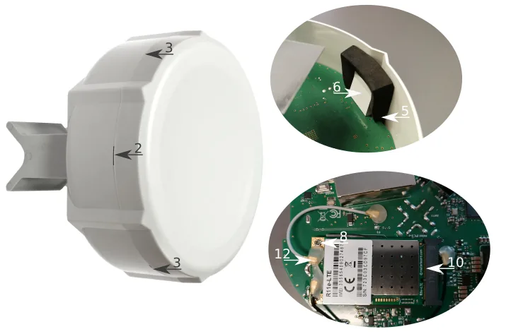

MiniPCIe slot usage
This SXT version is without a factory modem installed. In order to install the module, you will need to remove the plastic top and withdraw the PCB plate from the bottom case. Installing a miniPCIe module should be done by a qualified person, follow safety precautions when handling electrical equipment:
  • Use a wrist grounding strap when unpacking and working with electrical components to avoid electrical discharge (ESD) damage.
  • Removing the top cover, insert plastic tool in one of the six holes, turn slightly to the side and twitch carefully to slightly release the cover from holding into the place.
  • Continue to work around until all of the clamps are released.
  • Remove the top cover by lifting it up.
  • You will access the upper side of PCB and antenna, remove two black soft pads to access PCB holders.
  • Push both plastic holders to opposite sides to release the PCB board from its position.
  • Remove the PCB board, carefully lift it up and place it on the anti-static mat.
  • Locate the mini PCIe slot on the bottom of the PCB and remove two factory attached screws.
  • Attach provided a thick thermal pad to the card.
  • Install the card into a miniPCIe slot so that the thermal pad is between PCB and card.
  • The secure card in place using previously removed two screws.
  • Attach the grey uFL connector to the MAIN antenna connector of the modem, attach the black cable to the secondary (or AUX) connector. Use silicone type rubber to secure wiring in place.
  • Attach a thinner thermal pad to the top of the card.
  • Reassembly in backorder. After you have reinserted the device into the case, slide in the SIM cards from your mobile operator into the SIM slots, with the chips facing down.

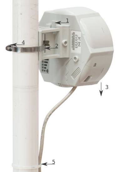

Mounting
SXT designed to be mounted on the pole, the package includes mounting bracket and steel clamp.
  • With the clip pointed forward, slide the mounting bracket into the rail on the bottom of the case, until the clip clicks into place.
  • Guide the clamp through the opening in the bracket.
  • Attach the unit to a pole, with the Ethernet port pointing downward.
  • Use a PH2 screwdriver to tighten the rings when alignment is complete.
  • Fix the Ethernet cable to the pole using zip ties, less than one meter from the unit, to avoid the cable being pulled out of the port.
  • Check mounting angle and positioning. When mounting outdoors, ensure that any cable openings are directed downwards. Use POE injector and proper grounding, this device has specially designed grounding connector under the port cover. Recommended using Cat5/6 cable. The IP rating scale for this device is IP54. The SXT device has a sliding door, behind which the Ethernet ports and the reset buttons are located. This door can be also secured shut with a screw in the provided screw hole. When using both Ethernet ports, make sure to cut a wider cable opening in the plastic door. You can use pliers to tear out the plastic piece that is protecting the cable opening. When closing the plastic door, make sure to apply pressure, until it "clicks" into place. Mounting and configuration of this device should be done by a qualified person.

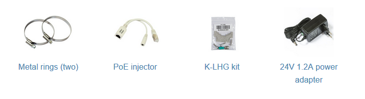

Accessories
Package includes the following accessories that come with the device:
