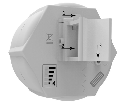

SXT is designed to be mounted on the pole, the package includes a mounting bracket and steel clamp.
  • With the clip pointed forward, slide the mounting bracket into the rail on the bottom of the case, until the clip clicks into place.
  • Guide the clamp through the opening in the bracket.
  • Attach the unit to a pole, with the Ethernet port pointing downward.
  • Use a PH2 screwdriver to tighten the rings when alignment is complete.
  • Fix the Ethernet cable to the pole using zip ties, less than one meter from the unit, to avoid the cable being pulled out of the port.
  • Check mounting angle and positioning. When using both Ethernet ports, make sure to cut a wider cable opening in the plastic door. You can use pliers to tear out the plastic piece that is protecting the cable opening. When closing the plastic door, make sure to apply pressure, until it "clicks" into place. The mounting and configuration of this device should be done by a qualified person.
