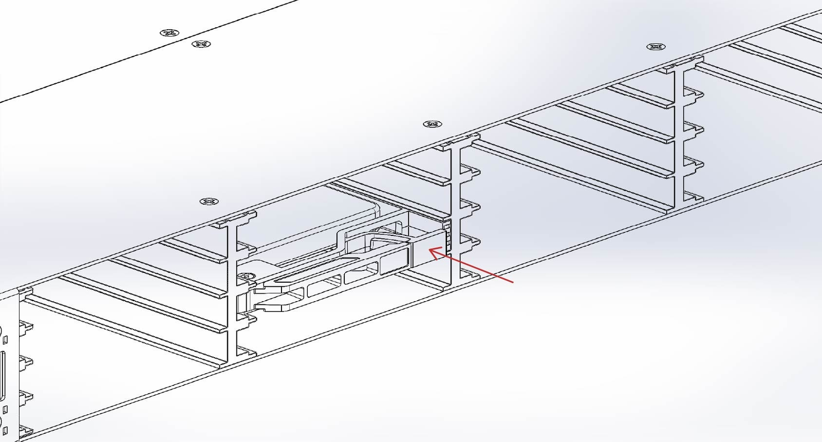

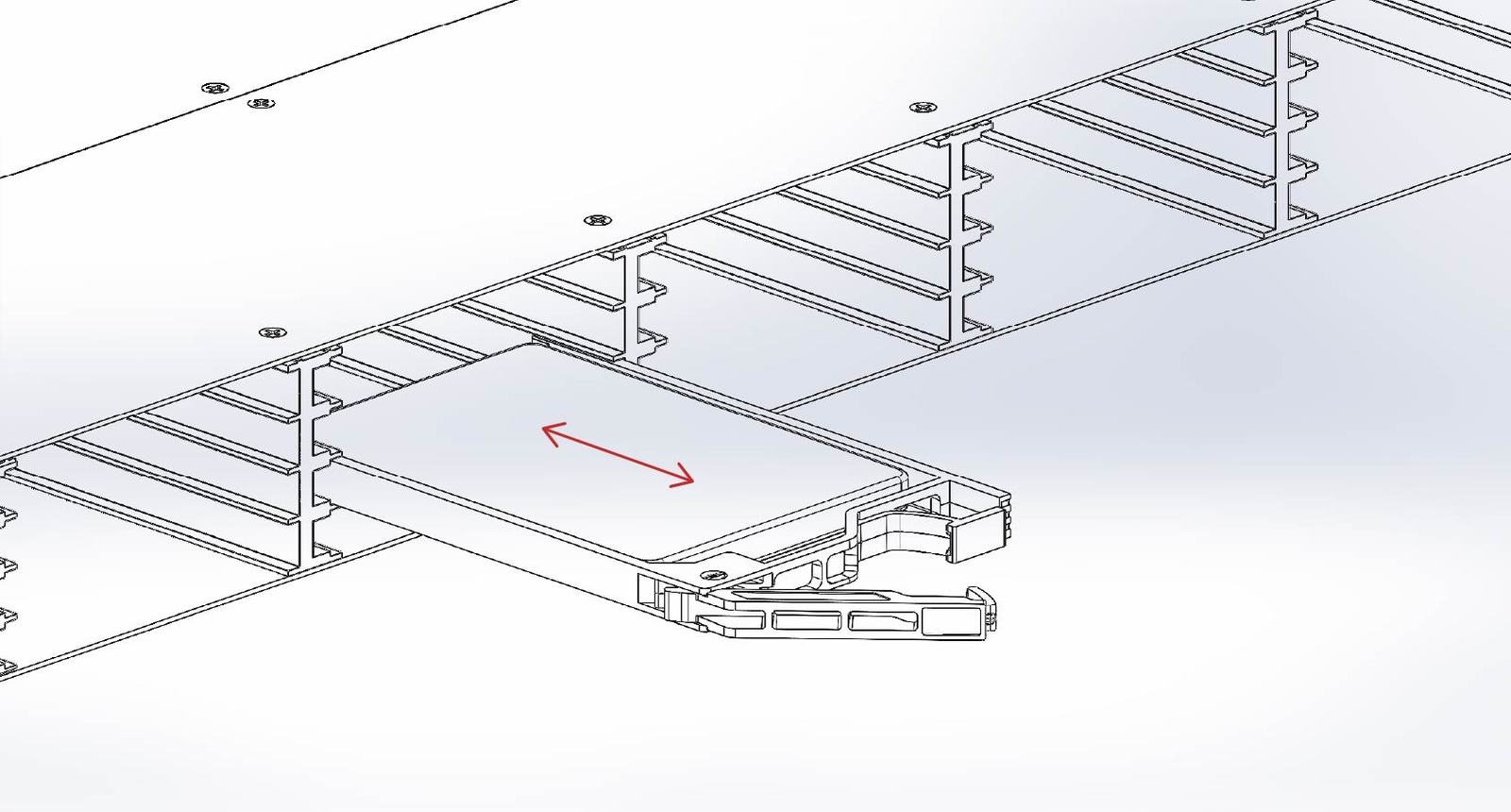

Install Disks​

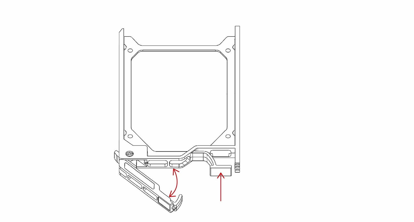

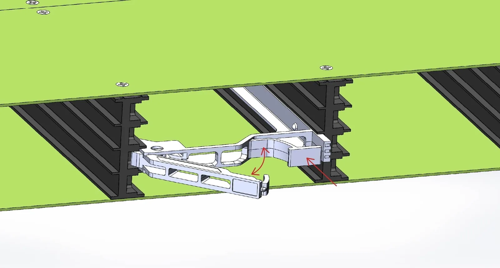

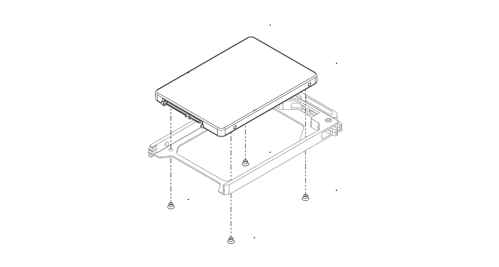

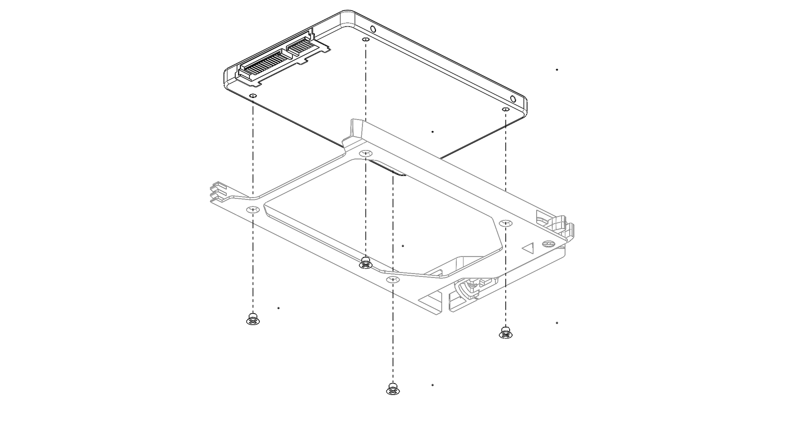

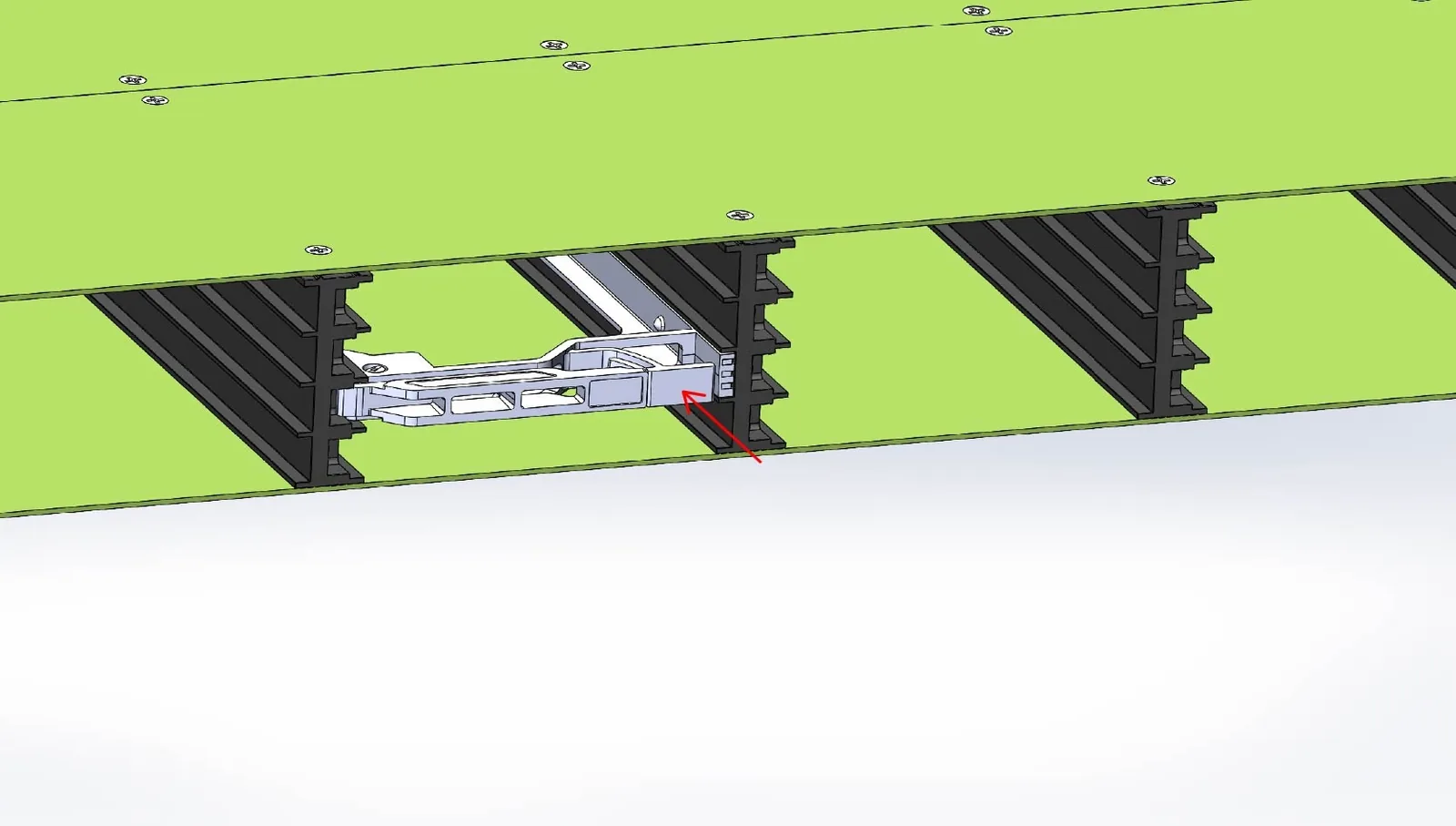

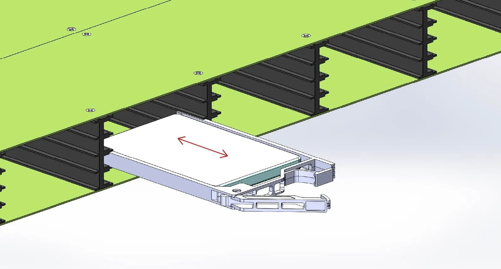

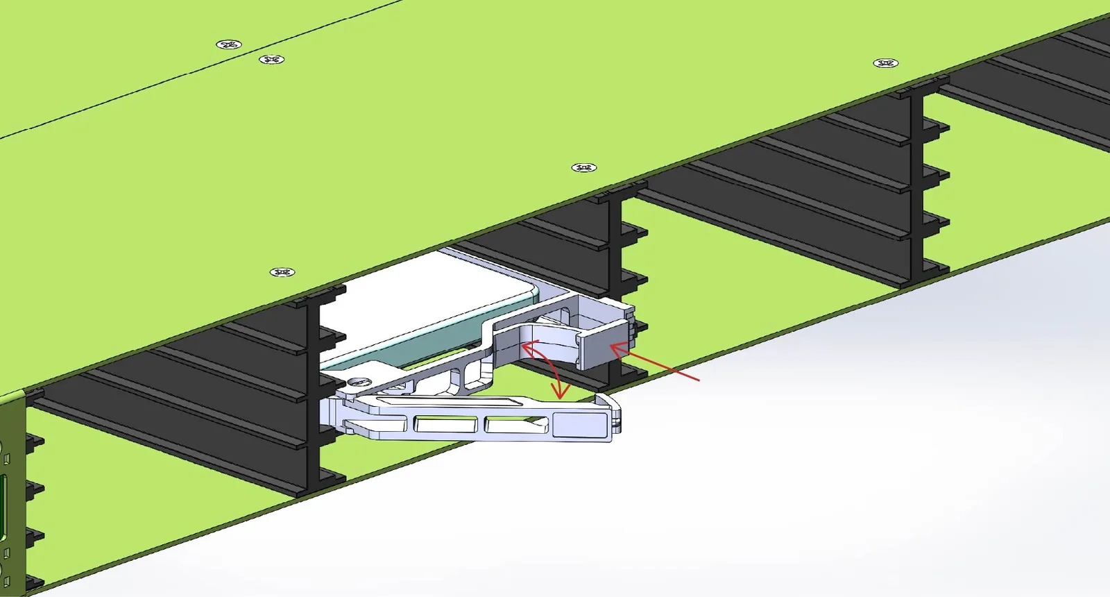

To install disks:

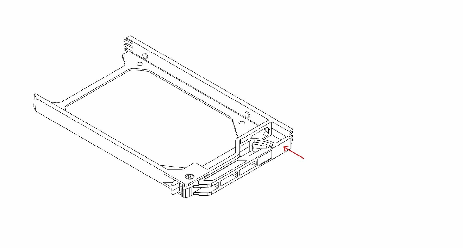

  1. Open the tray by pressing the button on the right side and pulling it out.
  1. Mount the disk inside the bracket (optionally securing it with screws).
  1. Insert the tray back into its slot, pushing forward until it locks.

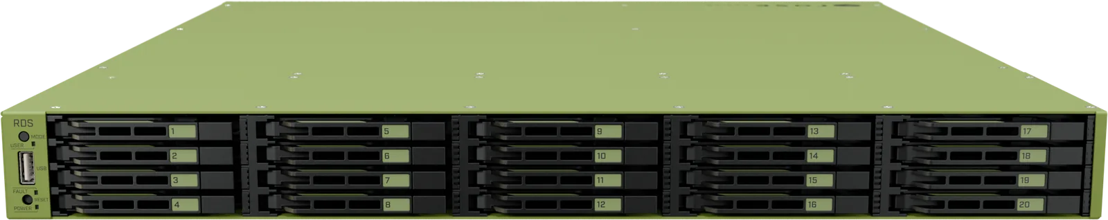

  1. Disk trays are numbered from the upper left (starting at 1) to the last tray at the bottom right.

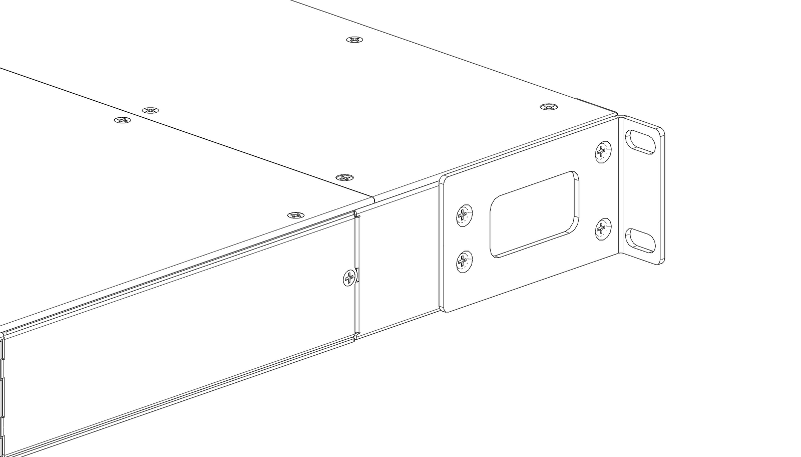

Mounting​

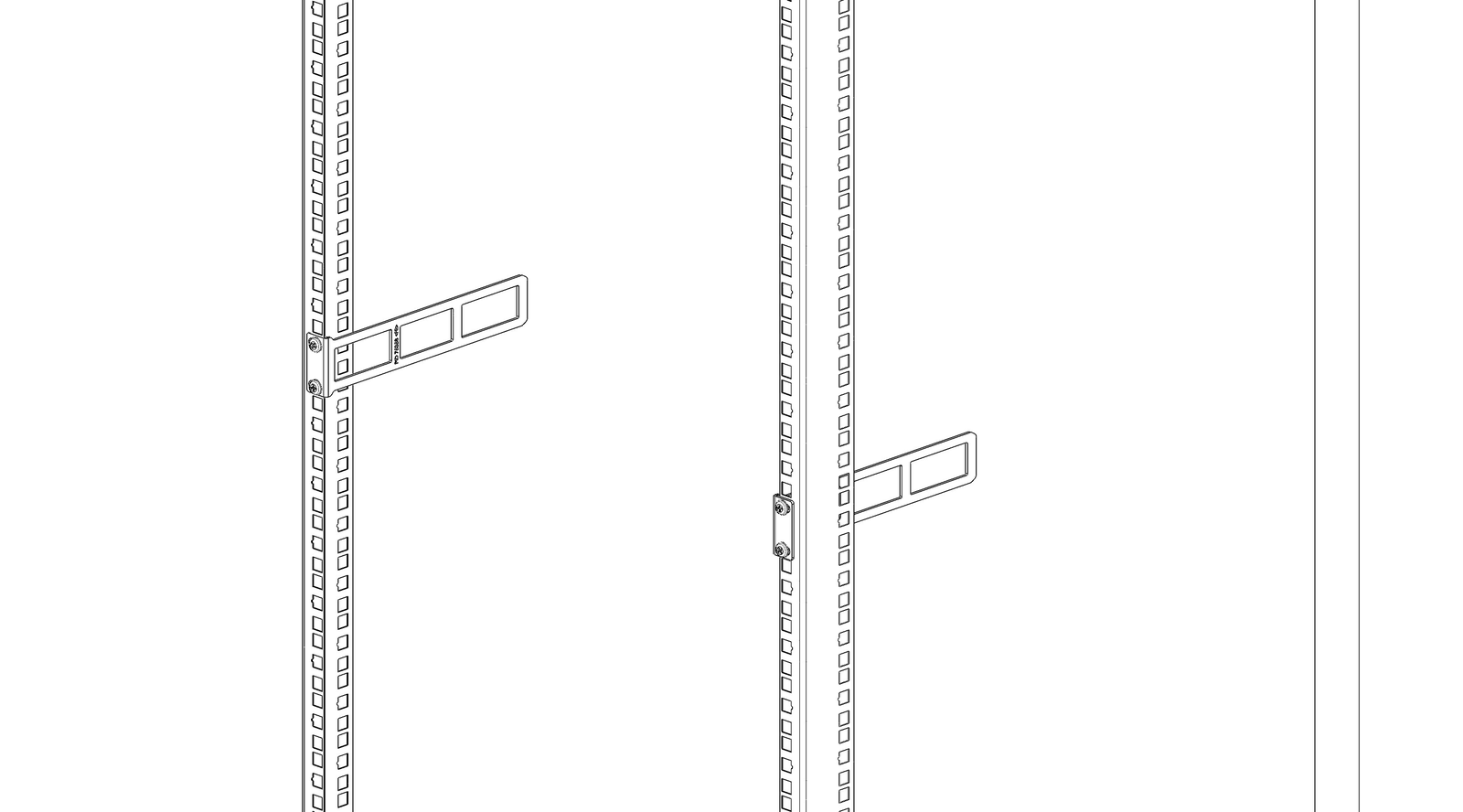

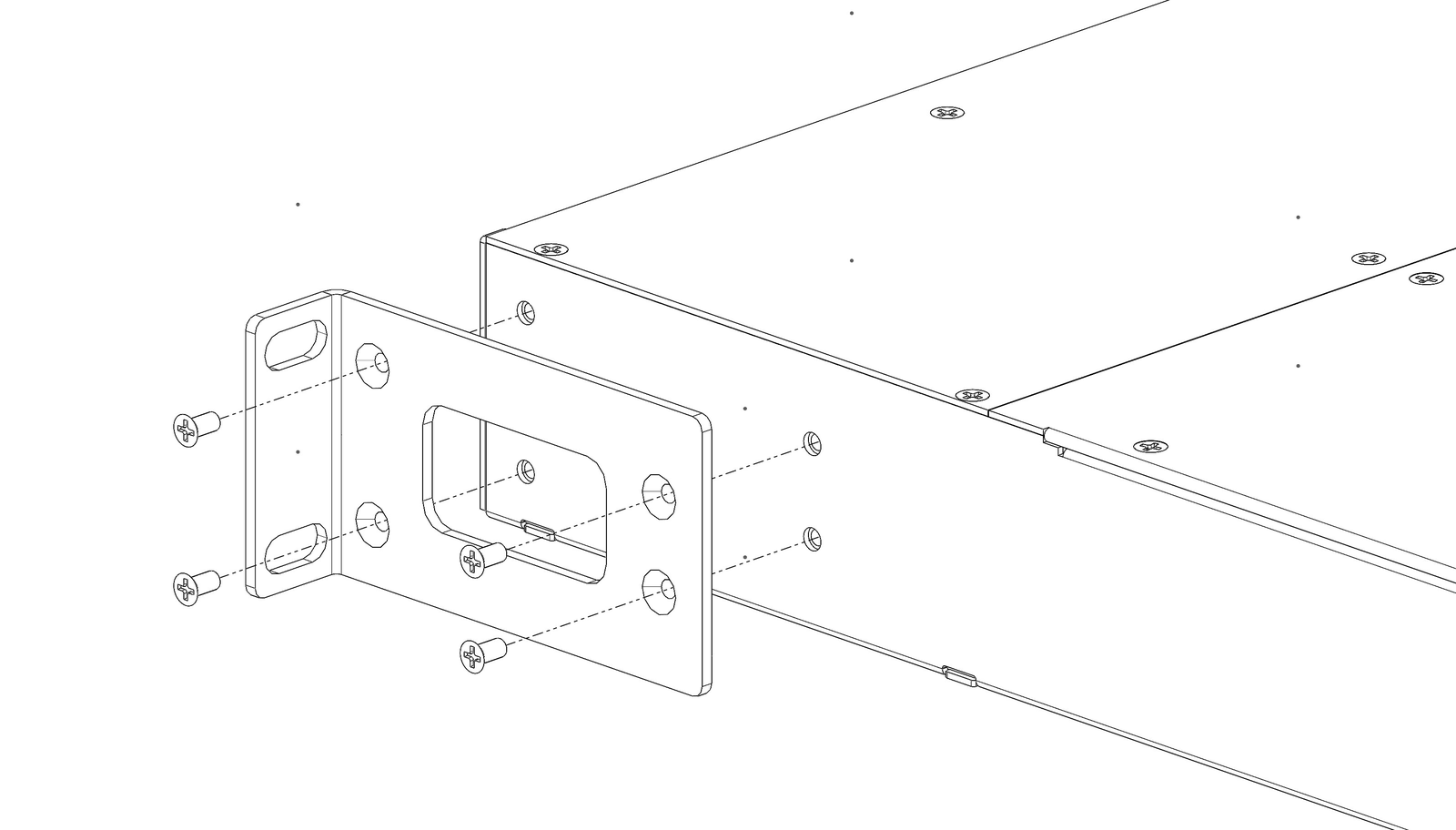

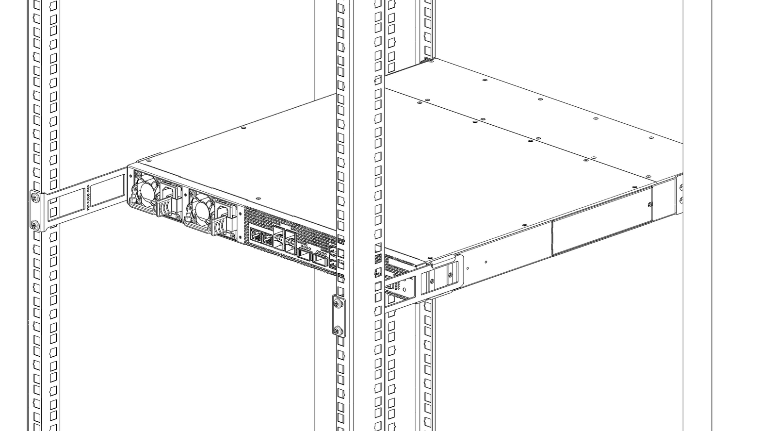

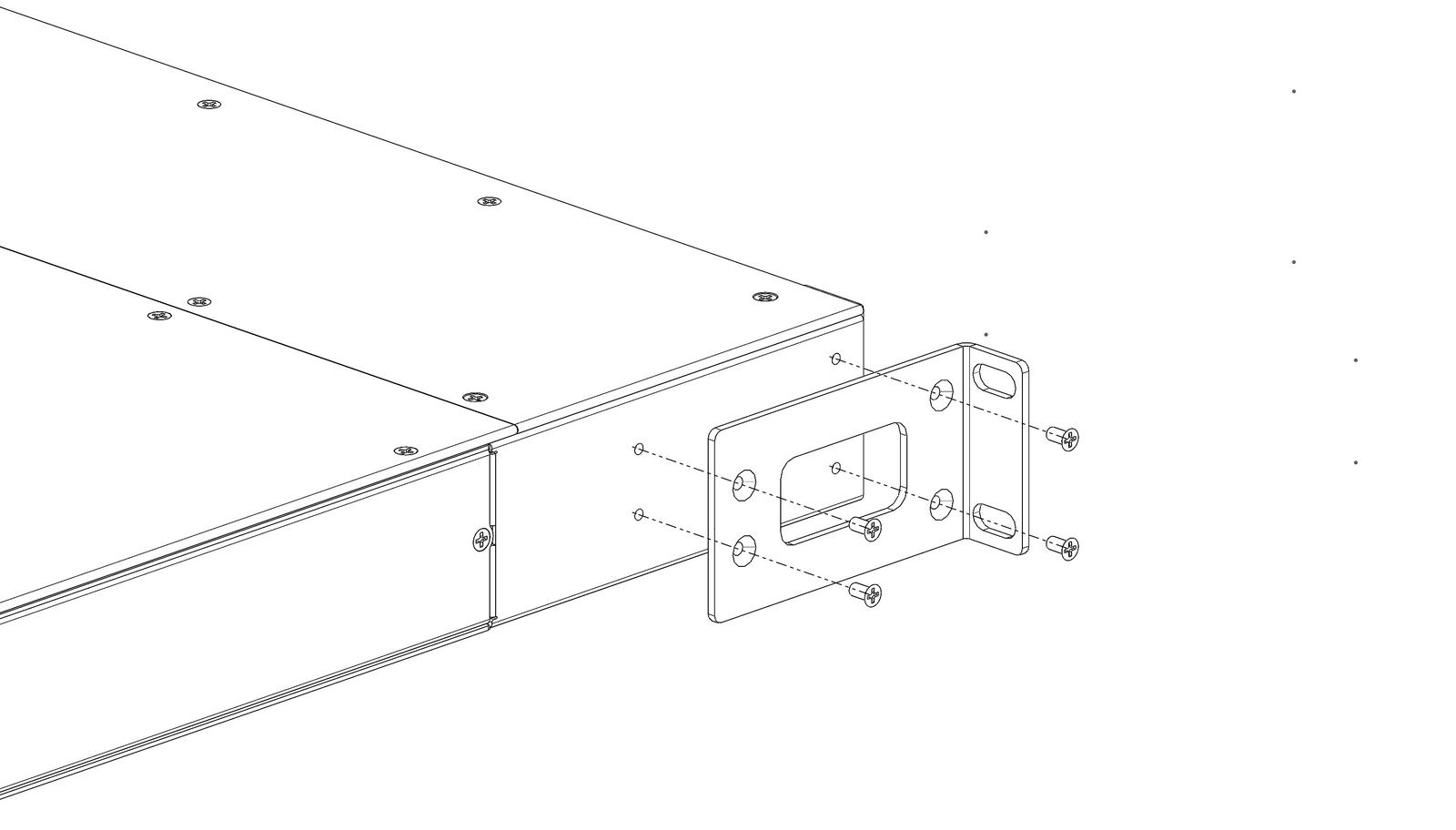

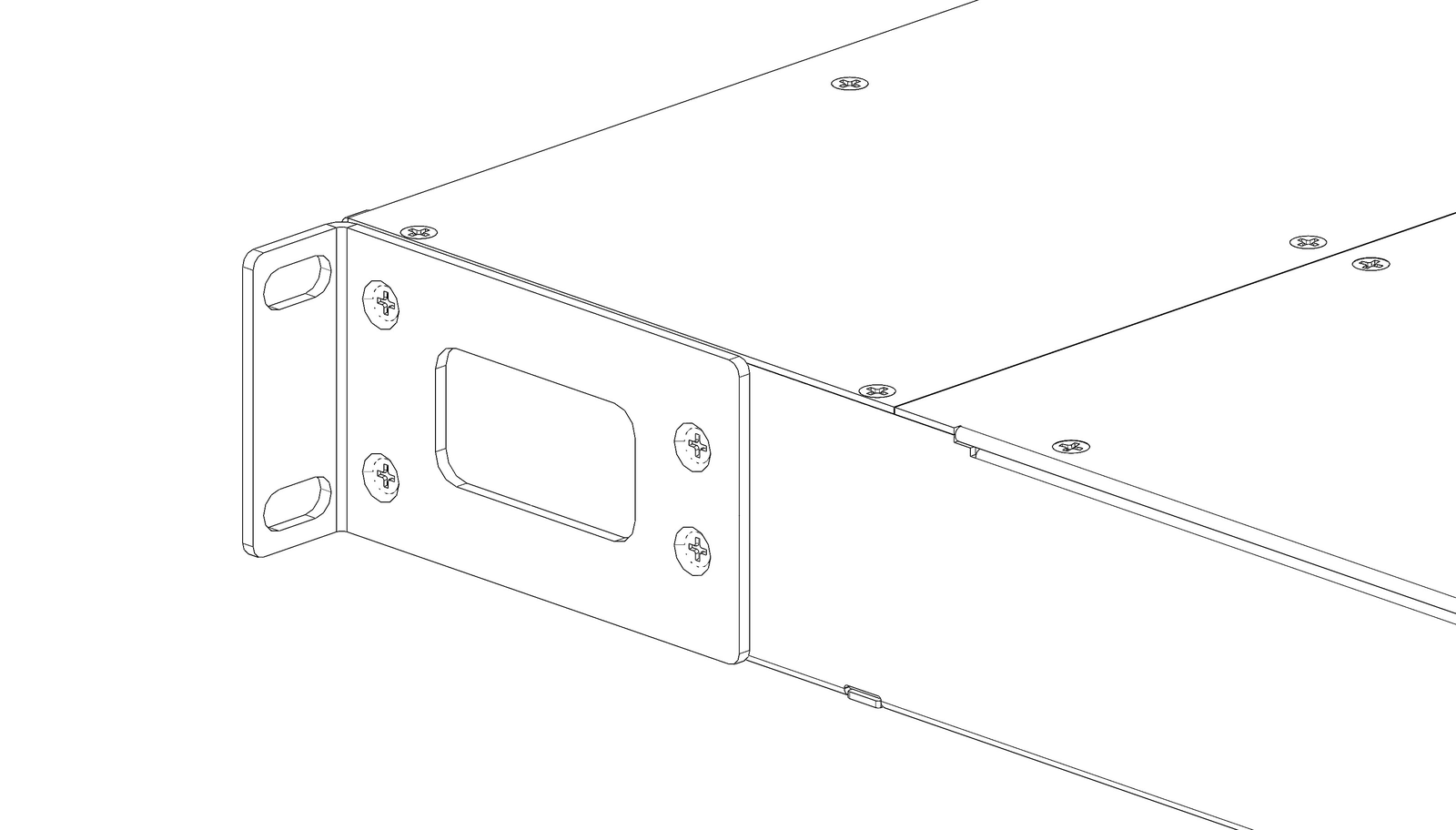

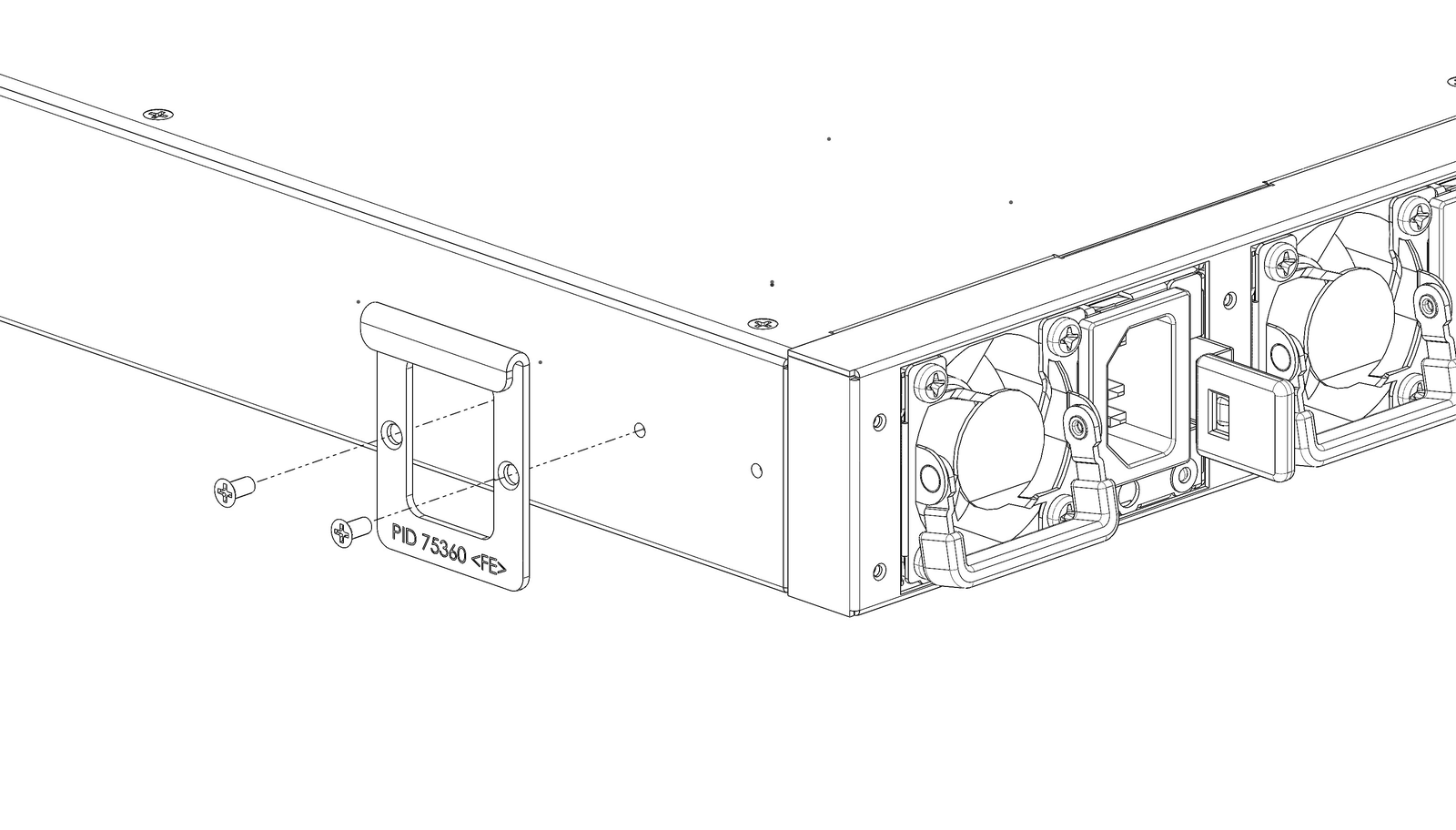

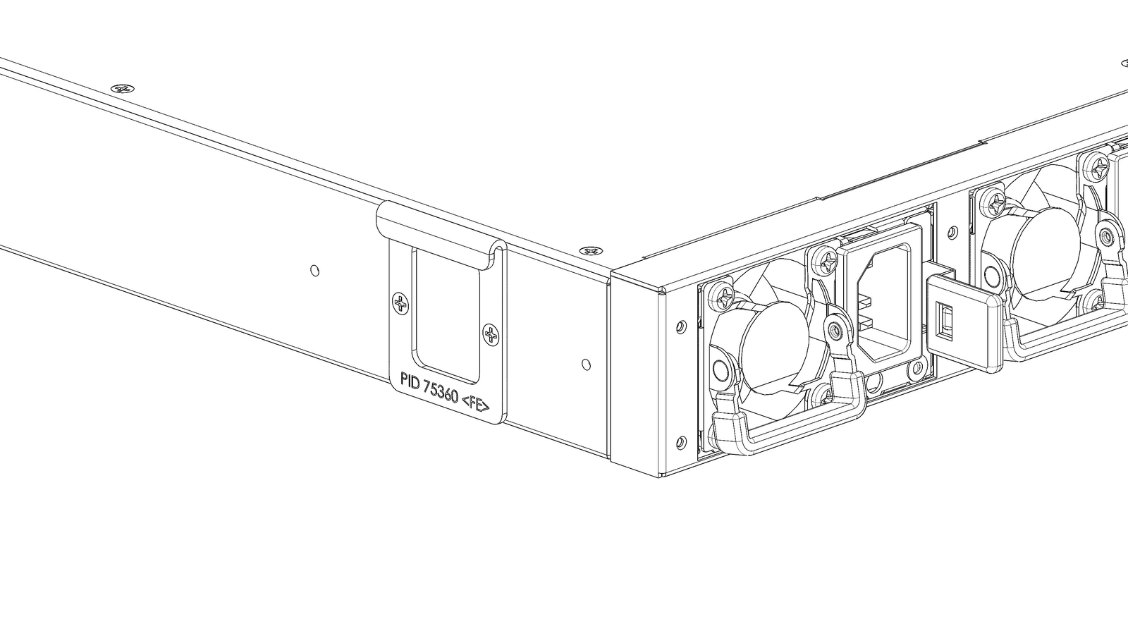

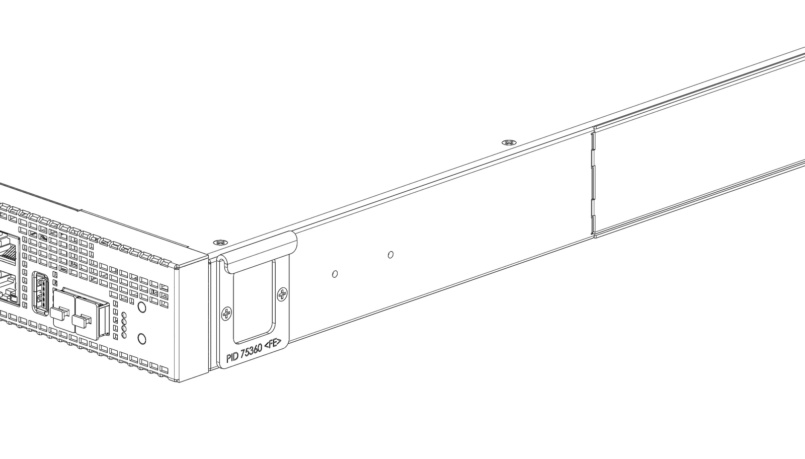

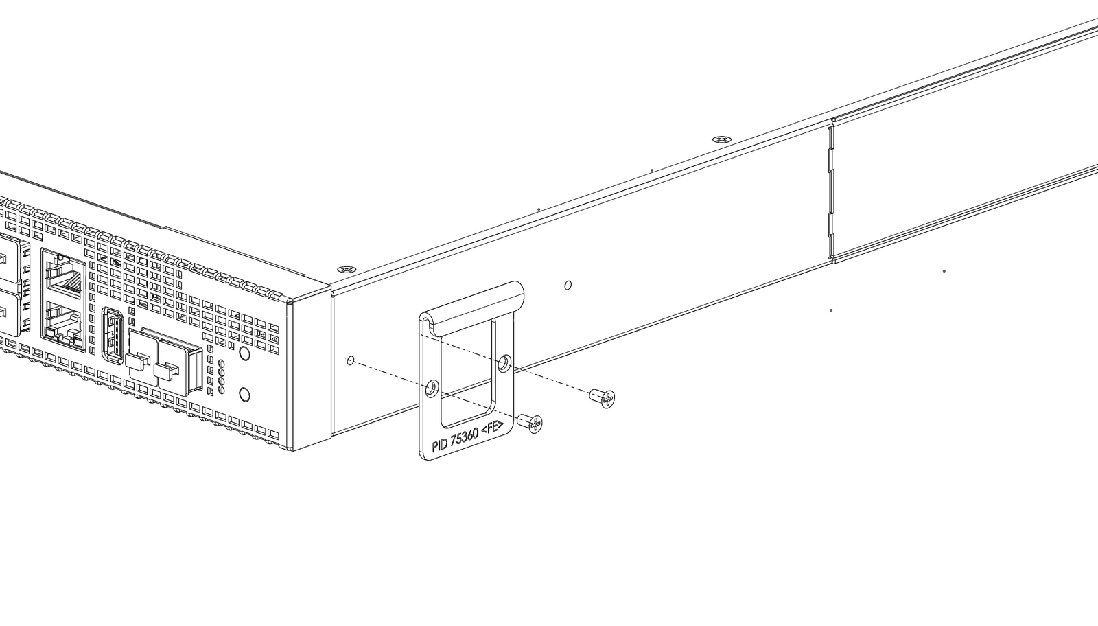

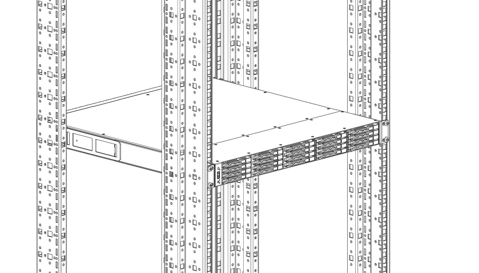

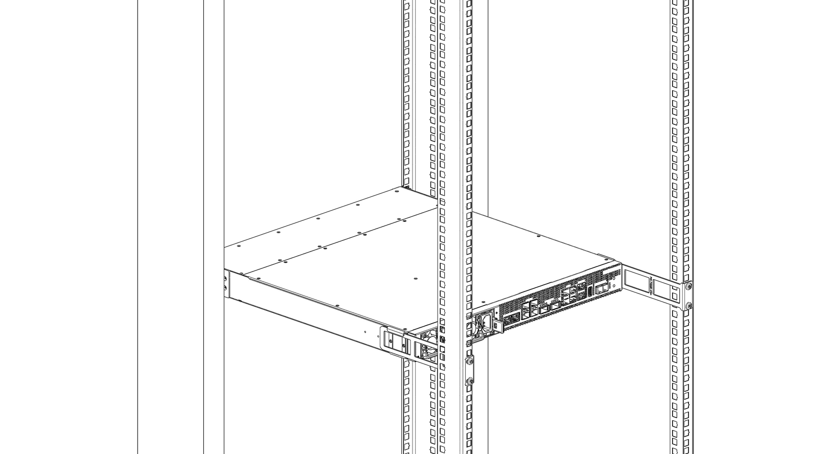

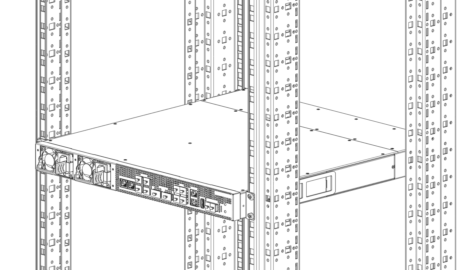

The device is designed for indoor use and can be either mounted in a rack using the provided rack mount ears or placed on a desktop. The included rack mount ear set is recommended for racks up to 600 mm deep. For rackmount installation, follow these steps using a Phillips screwdriver:
  1. Attach the Rackmount ears to the front sides of the device.

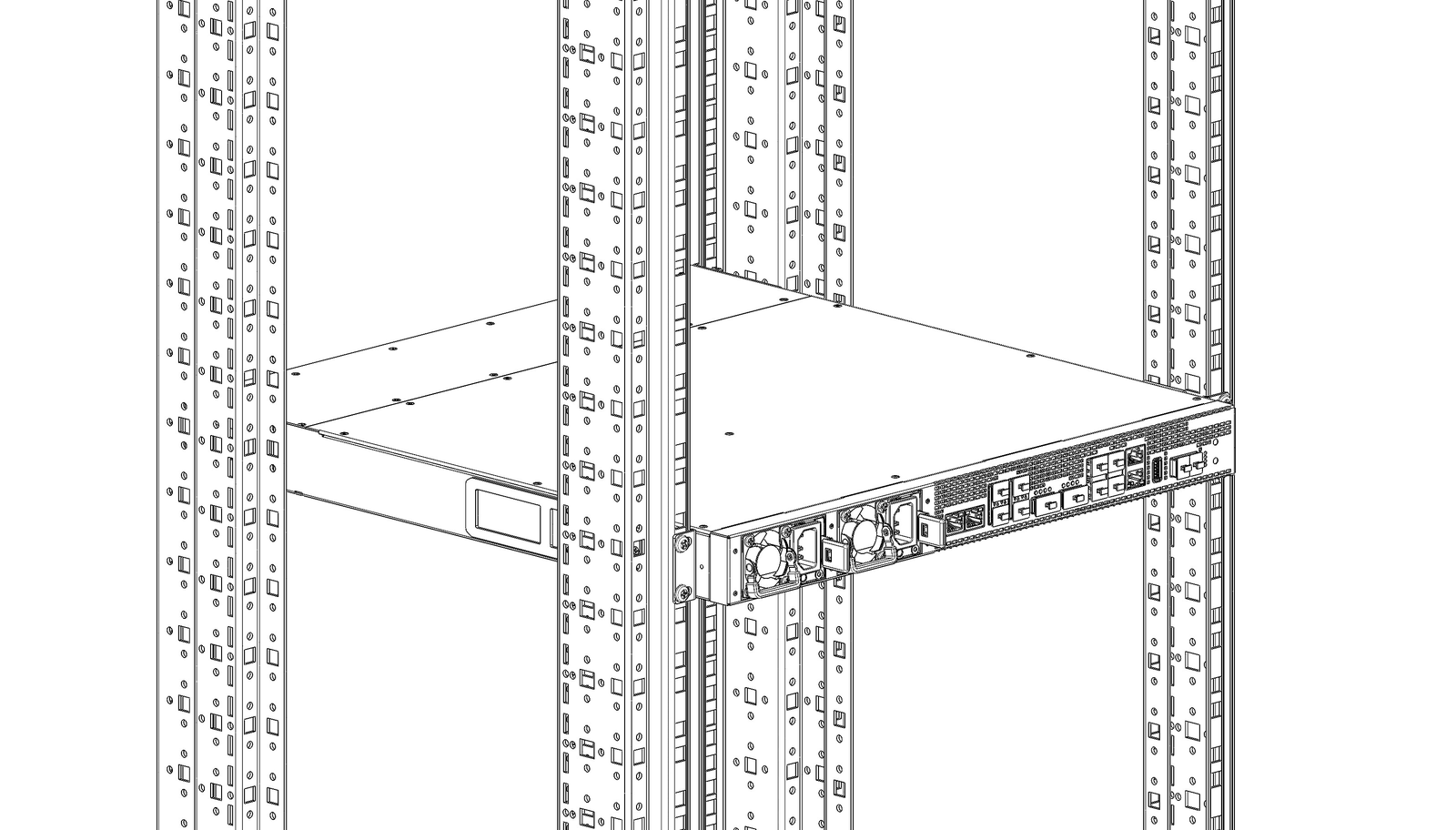

  1. Attach the small rear Rackmount support ears to both sides of the device.

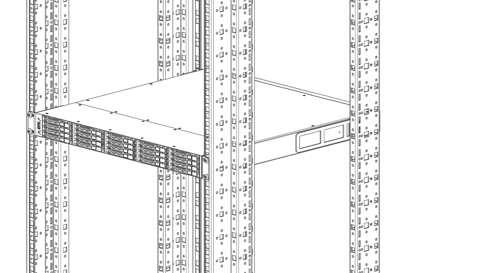

  1. Attach the long rear Rackmount support ears to the rack’s rear side.
  1. Install the device in the rack, ensuring that the case support ears are securely fixed to the long support ears.

  • The 2.5" Disk Tray LEDs (green and blue) indicate whether a disk is installed in the corresponding tray.
