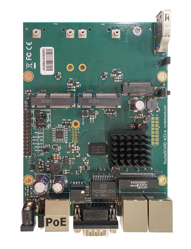

Extension slots and ports​
  • Three Gigabit Ethernet ports (With Auto MDI/X so you can use either straight or cross-over cables for connecting to other network devices). The J1 (first from the left) Ethernet port accepts 11-30 V DC powering from a passive PoE injector.
  • Two miniPCIe slots for either an 802.11 wireless card or a 3G/LTE modem. Mini-SIM 2FF slots available for miniPCIe 3G/LTE modems and have no functionality when a modem is not installed.
  • One M.2 (M key) slot for PCI-e SSD disk. The mounting hole is for 2242 size cards, for other sizes, an extender is suggested. Any speed M.2 cards will operate at 1x PCIe speed.
  • One microSD slot for a storage card.
  • One DB9 RS232 serial port for serial console access. Configured as 115200 bit/s, 8 data bits, 1 stop bit, no parity.

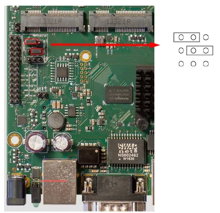

Boot configuration jumpers​
Default jumper configuration for MikroTik RouterOS boot:

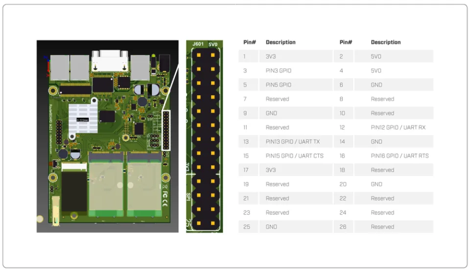

GPIO pinout​
M33 pinout is shown below:
All output pins are open drain.
Digital input voltage is 0 to 3.63 V max.
To receive a logical "0" on the pin, the voltage should be between 0 to 1.4 V.
To receive a logical "1" on the pin, the voltage should be between 1.41 to 3.63 V.
By default pins 12,13,15,16 are configured for the second "serial1" port usage:
/system/routerboard/settings/set gpio-function=serial1
They can be resigned for GPIO usage in /iot/gpio/digital menu with following commands:
/system/routerboard/settings/set gpio-function=""
