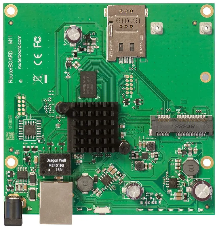

MiniPCIe slot​
Installing a miniPCIe module should be done by a qualified person, please follow safety precautions when handling electrical equipment:
  • Place the device on the anti-static mat.
  • Locate the miniPCIe slot and remove two factory attached screws.
  • Attach provided a thick thermal pad to the card, and install the card into miniPCIe slot so that the thermal pad is between PCB and card.
  • The secure card in place using previously removed two screws.
  • Attach the grey uFL connector to the MAIN antenna connector of the modem, attach the black cable to the secondary (or AUX) connector.
  • Attach a thinner thermal pad to the top of the card.
  • Mount unit in your desired location. After you mounted the device, slide in the SIM card from your mobile operator into the SIM slot, with the chip facing down. The slot accepts miniSIM (2FF).
