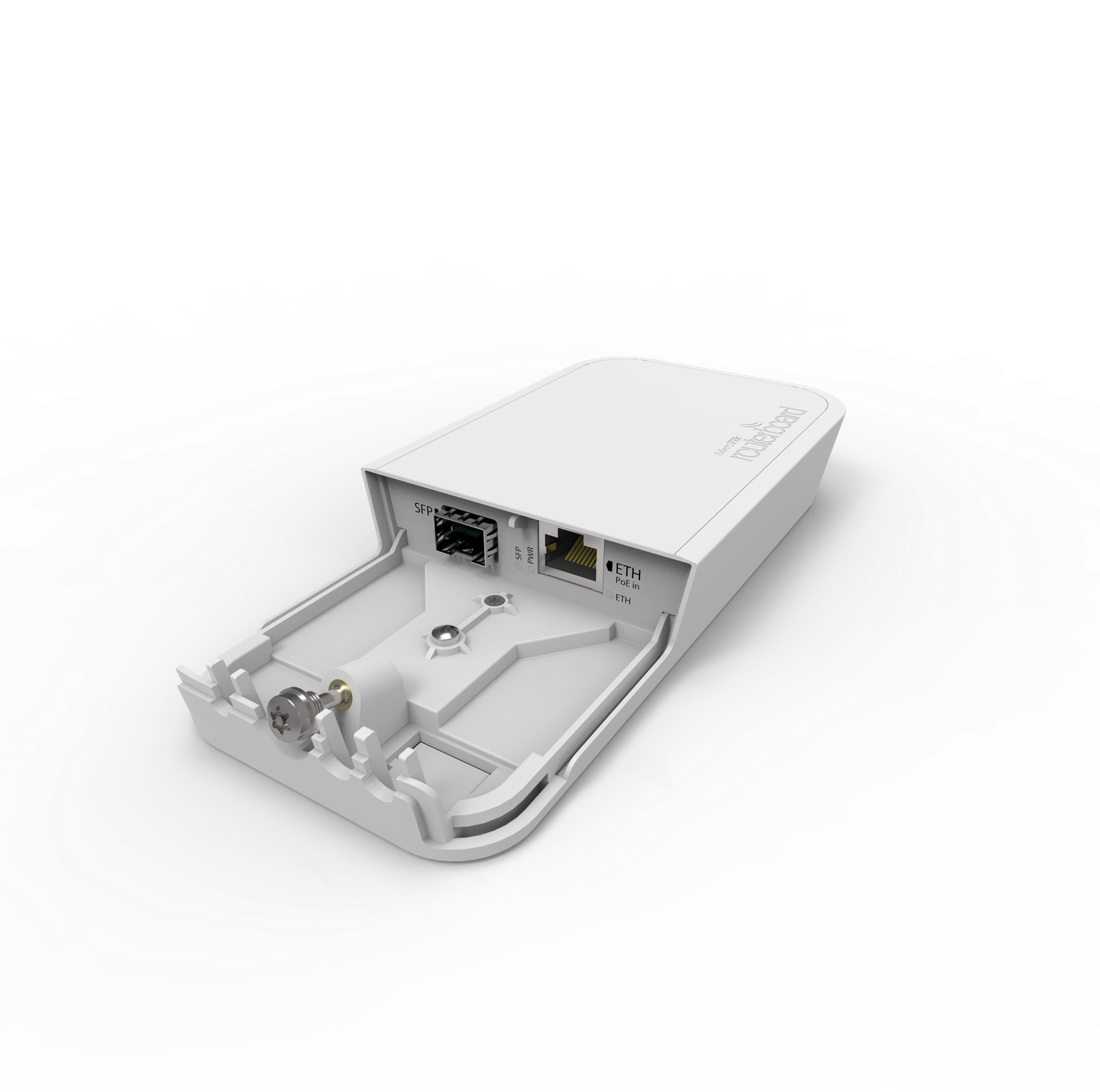

  • Open the Fiber and Ethernet port door;
  • Connect the device to the PoE injector using an Ethernet cable, ensuring it connects to the data+power end;
  • Connect the data end of the PoE injector to the computer;
  • Connect the power adapter to the PoE injector;

The device accepts power from the power jack or from the Ethernet port:
  • Direct-input power jack (5.5 mm outside and 2 mm inside, female, pin positive plug) accepts 12-57 V ⎓ DC;
  • Ethernet port accepts 802.3af/at PoE. The power consumption under maximum load can reach 3 W.
Connecting to a PoE Adapter​
  • Connect the Ethernet cable from the device to the PoE+DATA port of the PoE adapter;
  • Connect an Ethernet cable from your local network (LAN) to the PoE adapter;
  • Connect the power cord to the adapter, and then plug the power cord into a power outlet.
