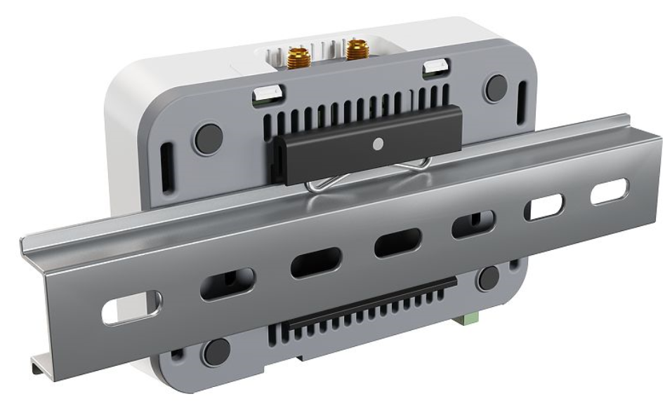

Mounting
  • The device can be mounted using provided DIN rail mount set. Designed to fit standard 35 mm x 7.5 mm DIN rails. Attach it with two provided screws to the device and attach the device to the DIN rail. The DIN rail is not provided in the package.
  • Alternatively, it is possible to attach the device to a wall, using the provided screw holes on the back of the unit. The device should be mounted in a way that the cable openings are pointing downward as shown in the picture. Warning! This equipment should be installed and operated with a minimum distance of 20 cm between the device and your body. The operation of this equipment in the residential environment could cause radio interference. Mounting and configuration of this device should be done by a qualified person.

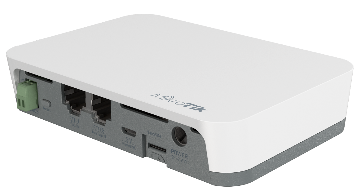

Extension slots and ports
  • 2.4 GHz, 802.11b/g/n, antenna gain 1.5 dBi.
  • Built-in GPS module (GPS, GLONASS, BeiDou, Galileo) for KNOT, KNOT LR8 and KNOT LR9. KNOT LR8G/9G has a GPS module inside the LR card (which does not support GLONASS, BeiDou, Galileo).
  • Two 10/100 Ethernet ports, supporting automatic cross/straight cable correction (Auto MDI/X). Either straight or crossover cable can be used for connecting to other network devices. The Ethernet port accepts 12-57 V DC power from an 802.3af/at PoE injector.
  • One microUSB 2.0 port for powering (for KNOT LR8/LR8G and KNOT LR9/LR9G kits only the port can be also used for peripherals).
  • One nano SIM slot.

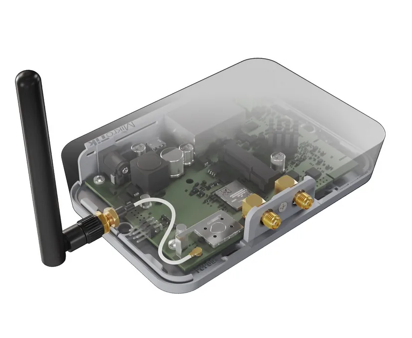

Bluetooth antenna
By default, the KNOT has a built-in internal antenna that can be used but it is also possible to connect an external antenna instead to increase Bluetooth operation range. This is relevant for the KNOT RB924i-2nD-BT5&BG77 devices.
For the KNOT LR8 kit, KNOT LR8G kit, KNOT LR9 kit and KNOT LR9G kit, Bluetooth external antenna pigtail placeholder is not available (there is already an SMA slot in place that is used by the LoRa).
To use an external antenna, you will need a U.FL (female) to SMA connector (pigtail) and a Bluetooth antenna (that can be attached to the SMA).
  • Unscrew the screw between two SMA slots for CAT-M/NB and GNSS and remove the case.
  • Connect U.FL (female) pigtail to the BT slot on the board (as shown in the picture above).
  • Drill the hole in the board's case in the specific spot (circular outline from the inside of the case) as per the picture, and attach SMA to the case (where the hole was drilled).
  • Connect Bluetooth antenna to the SMA slot. You will need to change the antenna that you wish to use (newly connected "external" or the build-in "internal") in the RouterOS settings (under IoT→ Bluetooth→Devices→double-click on the Bluetooth interface→ in the "Antenna" field):
U.FL to SMA pigtail and the external Bluetooth antenna are not provided with the package.

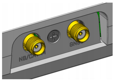

GPS and NB/CAT-M
Attach your antennas to the SMA connectors:
BG77 supports NB and GNSS. For the KNOT, KNOT LR8 and KNOT LR9 kit, both (NB+GNSS) cannot be used together simultaneously.
An example of the configuration to automate the switch between the cellular and GNSS priority is shown below under the Cellular and GNSS priority switch automation section. Please also check the guide at - WWAN and GNSS priority automatization.
This is not relevant for KNOT LR8G kit and KNOT LR9G kit (as the GPS module is on the LoRa card) and both GPS+NB can work at the same time for this model.
External antennas must be connected to use the Narrow Band modem and GPS. Not provided with the package.

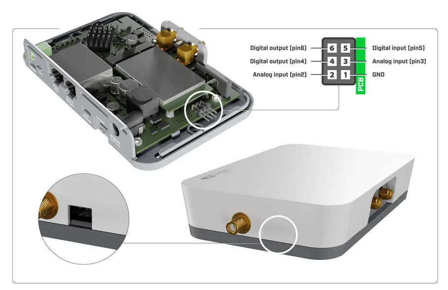

GPIO pinout
GPIO pins are located on the board under the case as shown in the picture:

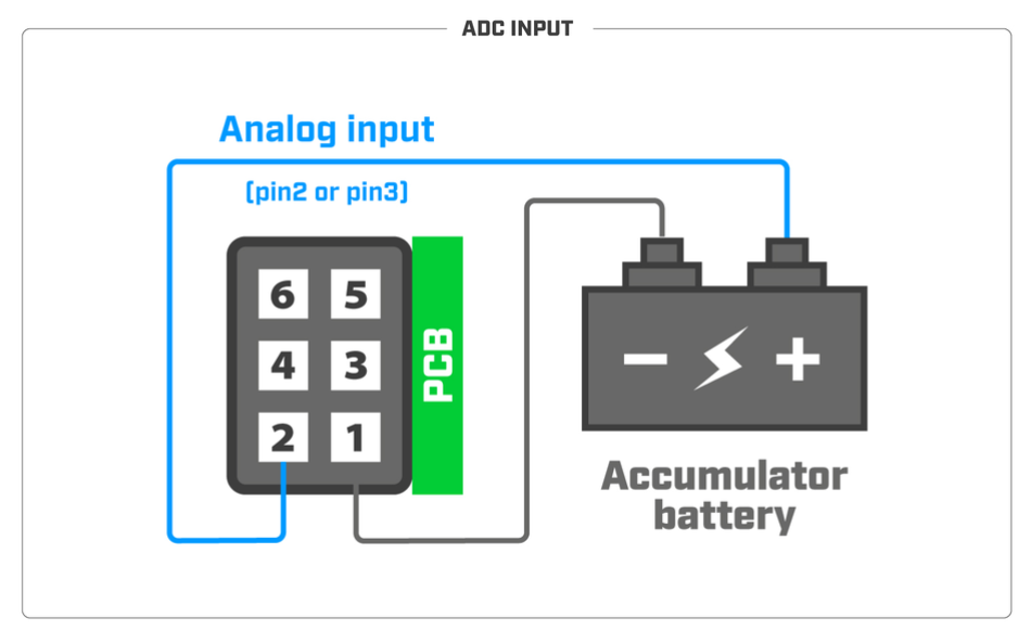

ADC input/analog input (pin2 or pin3):
note: Analog input voltage is 0-60 V. Theoretical resolution is 4 mV (14bit ADC). Analog input impedance is approximately 72K Ohm.

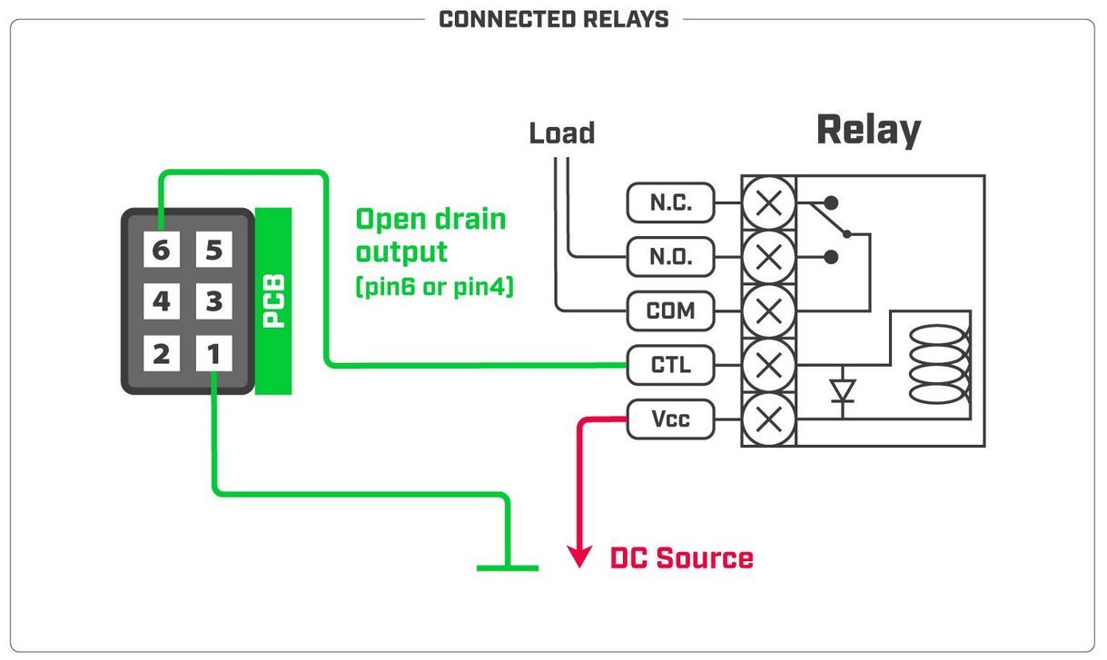

Connected relays (pin4 or pin6):
note: The maximum power dissipation (for digital output open drain transistor) is 0.48 W.It is recommended not to exceed 24V or 0.5A during continuous operation. Absolute maximum drain-source voltage is 30V , and the maximum amperage is 2.8A .
GPIO output has an open drain configuration. Logical state "0" (open transistor state) sets the output transistor in a low resistance state and the output is ~0V. Logical state "1" (closed transistor state) sets the output transistor in a high resistance state and the output voltage depends on the external circuit.

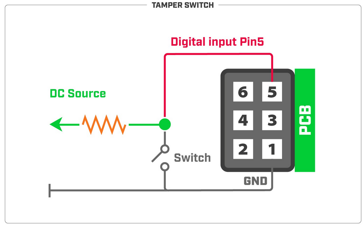

Tamper switch (pin5):
note: Digital input voltage is 0-2.5 V max.
Without PCB pull-up resistor:
  • to receive a logical "0" on the pin, the voltage should be between 0-1.47 V;
  • to receive a logical "1" on the pin, the voltage should be between 1.48-2.5 V. With PCB pull-up resistor:
  • to receive a logical "0" on the pin, the voltage should be between 0-1.34 V;
  • to receive a logical "1" on the pin, the voltage should be between 1.35-2.5 V. Newer routerboards will have a pull-up resistor on the PCB (on the board) - 10k ohm. Older boards (the first released batch) may need an external pull-up resistor.
