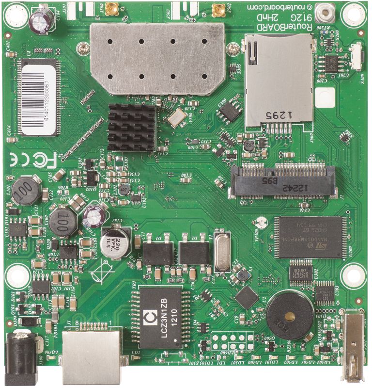

  • note that ETH, USB port and DC jack are extending over the perimeter of the PCB plate. The device can be mounted in your desired location using the factory provided four holes in a PCB plate, located on each side of the device. Warning! This equipment should be installed and operated with a minimum distance of 380 cm between the device and your body. Operation of this equipment in the residential environment could cause radio interference.

  • One gigabit ethernet port (With Auto MDI/X so you can use either straight or cross-over cables for connecting to other network devices). The ethernet port accepts 10-30 V DC powering from a passive PoE injector.
  • One miniPCIe slot. This device might be incompatible with the R11e-LTE international modem.
  • USB slot type A.
  • SIM card slot.
