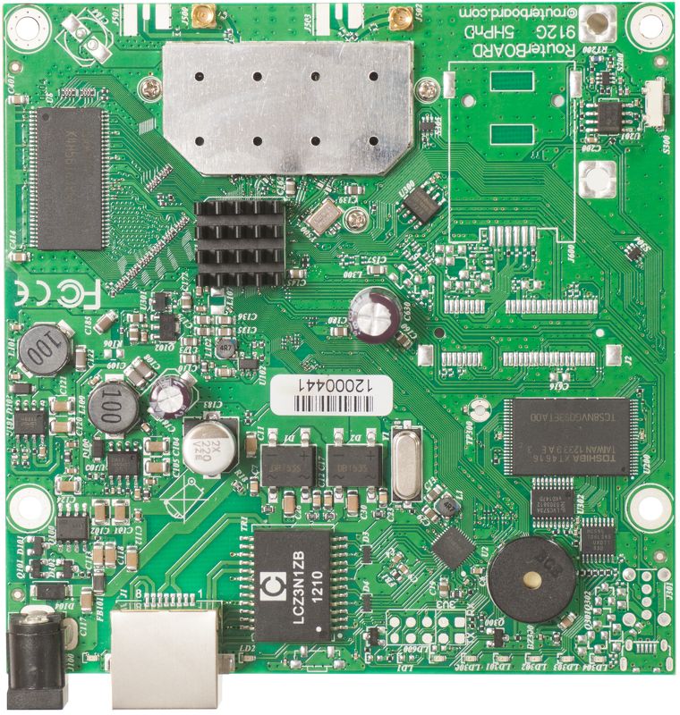

First use​
  • (Optional) Install the device in a case.
  • Connect and Ethernet cable to the Ethernet port.
  • Plug-in power cable to turn on the device.
  • Open network connections on your PC, mobile phone or other device and search for MikroTik wireless network and connect to it.
  • The configuration has to be done through the wireless network using a web browser or mobile app - (see ""). Alternatively, you can use the WinBox configuration tool https://mt.lv/winbox.
  • Once connected to the wireless network, open https://192.168.88.1 in your web browser to start configuration, user name: admin and there is no password by default (or, for some models, check user and wireless passwords on the sticker).
  • We recommend clicking the "Check for updates" button and updating your RouterOS software to the latest version to ensure the best performance and stability.
  • Choose your country, to apply country regulation settings and set up your password on the screen that loads.

Powering​
The device accepts power with the following modes:
  • Passive 10-30 V DC ⎓ PoE to Ethernet port. The higher the voltage needed to compensate for power loss on long cables. At least 18 V is suggested.
  • Direct input to the power jack 10-30 V. DC ⎓.
Connecting to a PoE Adapter​
  • Connect the Ethernet cable from the device to the PoE+DATA port of the PoE adapter.
  • Connect an Ethernet cable from your local network (LAN) to the PoE adapter.
  • Connect the power cord to the adapter, and then plug the power cord into a power outlet.

Buttons and jumpers​
RouterBOOT reset button has the following functions:
  • Hold this button during boot time until LED light starts flashing, release the button to reset RouterOS configuration (total 5 seconds).
  • Keep holding for 5 more seconds, LED turns solid, release now to turn on CAPs mode (total 10 seconds).* Keep holding the button for 5 more seconds until LED turns off, then release it to make the RouterBOARD look for Netinstall servers (total 15 seconds). Regardless of the above option used, the system will load the backup RouterBOOT loader if the button is pressed before power is applied to the device. Useful for RouterBOOT debugging and recovery.
