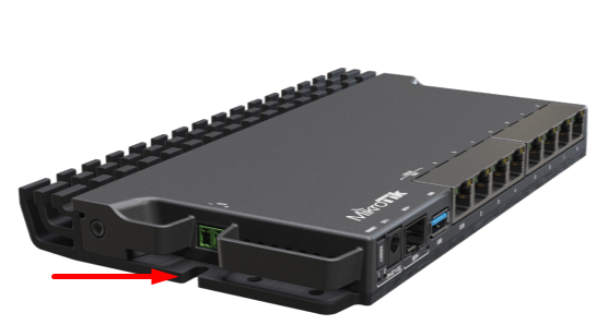

Mounting​
The device is designed to use indoors and it can be mounted on the wall, or it can be placed on the desktop.
  • Find the designed mounting holes on both sides of the device, as shown in the picture;
  • Use provided screws to secure the device to the wall;
  • Based on the wall material you can use a drill bit and provided dowels. The device has no protection from water contamination, please ensure the placement of the device in a dry and ventilated environment. We recommend Cat6 cables for our devices. The mounting and configuration of this device should be done by a qualified person.
