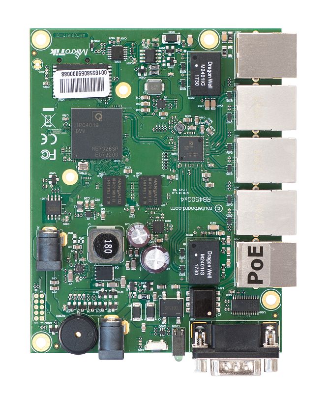

The RB450Gx4 is an Ethernet router with five Gigabit Ethernet ports, a serial port, two power jacks, and a microSD card slot. It is powered by MikroTik RouterOS. It comes without an enclosure, you are free to use it on your own.
  • Install the board in a case.
  • Connect Ethernet cables and plug in the microSD card (optional).
  • Plug-in power cable or PoE powered ethernet cable in Ether1 to turn on the device.

  • Five Gigabit Ethernet ports (Auto MDI/X). The first Ethernet port accepts 8-30V DC powering from a passive PoE injector or 802.3af/at PoE switch. Use 12V or more to compensate for any losses in cables. The other four Ethernet ports do not support PoE input.
  • The Ether5 port is capable of powering another RouterBOARD device with passive PoE (up to 57 V). The maximum output current is 500 mA.
  • Onboard DB9 RS232C asynchronous serial port is set by default to 115200bit/s, 8 data bits, 1 stop bit, no parity. Note that the device does not fully implement the hardware (RTS/CTS) flow control, so it is suggested to try to disable hardware flow control in the terminal emulation program.
  • microSD card for additional file storage.
