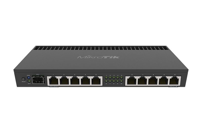

RB4011iGS+RM
The device is already configured with basic settings, you can simply plug in your ISP cable and start using the Internet. We recommend you set up a password to secure your device. See the RB4011iGS+RM product page for full specifications and brochures.

Setup​
  • Connect your Internet cable to the first port, and local network PCs to the other ports.
  • Choose your powering solution, please see the section for possibilities.
  • Set your computer IP configuration to automatic (DHCP).
  • The default IP address from the local network is 192.168.88.1, open this address in your web browser to start the configuration. The username is admin and there is no password (or, for some models, check user and wireless passwords on the sticker).
  • We recommend clicking the "Check for updates" button and updating your RouterOS software to the latest version to ensure the best performance and stability. The device needs to have an active Internet connection.
  • Set up a strong password for the device.

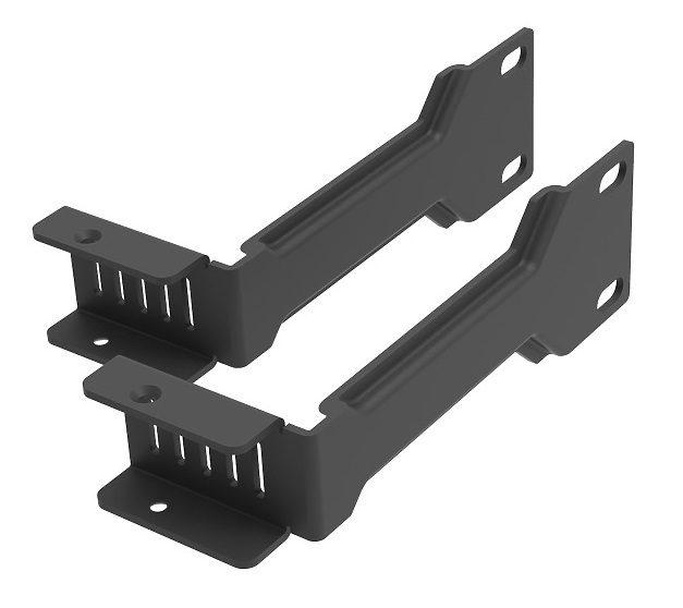

Mounting​
The device is designed to use indoors and it can be mounted in a rackmount enclosure using provided rack mounts, or it can be placed on the desktop. Please attach rubber pegs on the bottom of the router if the desired placement is on the flat surface or use a Phillips screwdriver to attach rackmount ears on both sides of the device if designated use is for rackmount enclosure:
  • Attach rack ears to both sides of the device and tighten four screws to secure them in place;
  • Place the device in a rackmount enclosure and align with the holes so that the device fits conveniently;
  • Tighten screws to secure it in place. The device has no protection from water contamination, please ensure the placement of the device in a dry and ventilated environment. We recommend Cat6 cables for our devices. Mounting and configuration of this device should be done by a qualified person.

Extension slots and ports​
  • The Ethernet ports are connected in two groups of five, each group is connected through a switch chip. The ports can be configured individually and support automatic cross/straight cable correction (Auto MDI/X), so you can use either straight or cross-over cables for connecting to other network devices.
  • SFP+ port accepts SFP and SFP+ modules. Refer to the MikroTik wired interface compatibility table.
  • RJ45 console port for serial console access, set by default to 115200 bit/s, 8 data bits, 1 stop bit, no parity.
Buttons and jumpers​
The RouterBOOT reset button has the following functions. Press the button and apply the power, then:
  • Release the button when the green LED starts flashing, to reset RouterOS configuration to defaults.
  • Release the button when the LED turns solid green to clear all configuration and bridge all interfaces.
  • Release the button after LED is no longer lit (~20 seconds) to cause a device to look for Netinstall servers (required for reinstalling RouterOS over the network). Regardless of the above option used, the system will load the backup RouterBOOT loader if the button is pressed before power is applied to the device. Useful for RouterBOOT debugging and recovery.
