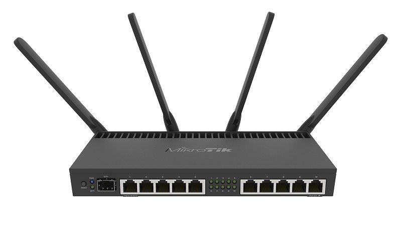

RB4011iGS+5HacQ2HnD-IN
RB4011iGS+5HacQ2HnD-IN (RB4011iGS+5HacQ2HnD-IN)​
