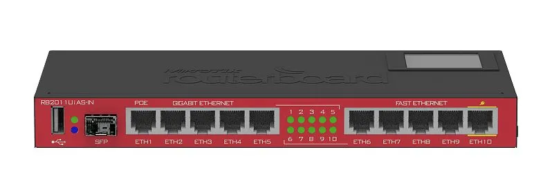

RB2011UiAS-IN is an indoor wired router with five Gigabit and five Fast Ethernet ports, an SFP cage, USB, an LCD panel, and PoE-out on Ether10. See the RB2011UiAS-IN product page for full specifications and brochures.

  • Five 10/100/1000 (Gigabit) Ethernet ports (Auto MDI/X)
  • Five 10/100 (Fast) Ethernet ports (Auto MDI/X)
  • Ether10 supports 500 mA output power, ~2 V below the input voltage. Power-out supports auto-detect to protect non-PoE devices.
  • 1G SFP port.
  • MicroUSB slot type AB.
  • Serial port.
  • LCD for configuration.
