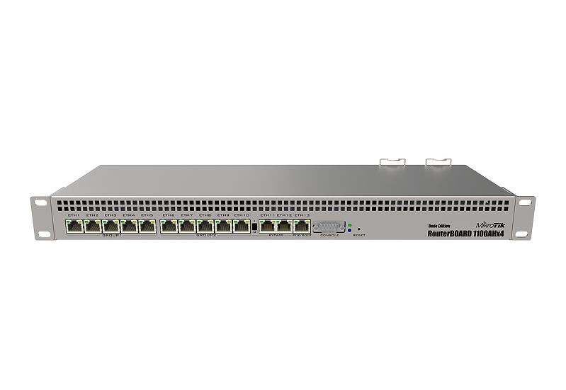

The RB1100 is a rack-mountable ethernet router with 13 Gigabit Ethernet ports. Two of the ports provide bypass functionality.

  • 13x Gigabit Ethernet ports, supporting automatic cross/straight cable correction (Auto MDI/X), so you can use either straight or cross-over cables for connecting to other network devices. ETH13 port accepts PoE power, and can be used to boot the device from the network for reinstalling with the Netinstall utility (see documentation)
  • DB9 RS232C asynchronous serial port
  • microSD slot
  • 2x M.2 slots, accepting SATA type M.2 SSD disks in 2280 form factor (only Dx4 model)
  • 2x 2.5 inch SATA connectors, accepting standard 2.5" SATA HDD disks (only Dx4 model) Recommended are SATA3 M.2 2242mm/2260mm/2280mm B+M key SSD disks with no capacity limitations.
