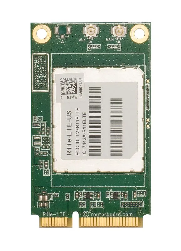

R11e-LTE-US is a Cat-4 modem. It can be integrated into any MikroTik product that has a miniPCI-e slot.

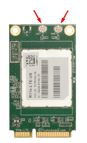

  • Attach antenna cables to the connectors on the module:
