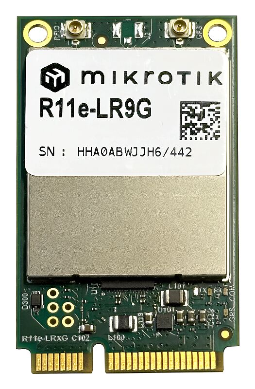

R11e-LR9G - LR mPCIe Gateway module. It can be integrated into a RouterBOARD product with mPCIe slot. Requires LR package installation to configure in RouterOS.

If your device does not have internal antennas, it is possible to connect to the external antennas by adding cable connectors, product code — ACSMAUFL. Please connect and disconnect the antenna, when the device is turned off!
Attach LoRa antenna cable to the "RFIO"-labeled connector for LoRa usage, and attach GPS antenna cable to the "GPS"-labeled connector for GPS usage:
