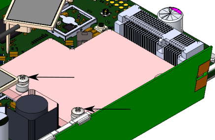

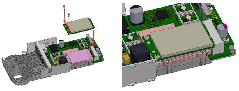

The card can be installed in your desired device using the factory provided screw holes in a PCB plate; Pictures added for illustration purposes, the device configuration, and the placement of the miniPCIe card may vary.
Locate miniPCIe slot on your device;
Unscrew two factory attached screws;

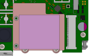

- Optionally you can use the thermal pad by placing it under the card, the thermal pad is not included in the package;
- Install the module to the miniPCIe slot and secure it with previously removed screws. Tightening torque 0,3 Nm.

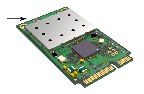

If your device does not have internal antennas, it is possible to connect to the external antennas by adding cable connectors, product code — ACSMAUFL. Please connect and disconnect the antenna, when the device is turned off!
- Attach antenna cable to the connector on the module:
