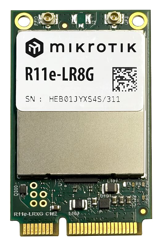

R11e-LR8G - LR mPCIe Gateway module. It can be integrated into a RouterBOARD product with mPCIe slot. Requires LR package installation to configure in RouterOS.

Low power-consuming with mini PCIe interface, for long-distance data, transmit:
  • Interface – Mini-PCIe;
  • Temperature Operating -40 / +70;
  • Supports Class A and C;
  • Frequency - 863-870MHz (EU);
  • RF Output power - 863-870MHz up to 27dBm (depending on region, limited up to 14dBm for EU);
  • Receive max sensitivity - 141 dB @ SF12, Depends on the antenna used;
  • Maximum power consumption 1.3 W;
  • GPS receiver U.FL slot (to connect external GPS antenna). GPS is supported (does not support GLONASS, BeiDou, Galileo).

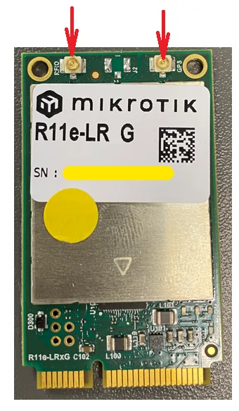

If your device does not have internal antennas, it is possible to connect to the external antennas by adding cable connectors, product code — ACSMAUFL. Please connect and disconnect the antenna, when the device is turned off!
Attach LoRa antenna cable to the "RFIO"-labeled connector for LoRa usage, and attach GPS antenna cable to the "GPS"-labeled connector for GPS usage:

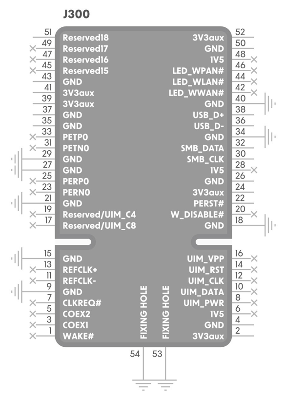

This warning only applies to mPCIe cards that are already preinstalled in MikroTik gateway devices, like WAP LR8. It is important to note here, that using pins 39 and 41is mandatory. If you want to use the card elsewhere, note that some USB to mPCIe adapters do not have mentioned pins connected and, without them, the LoRa card will not work. For a more detailed pinout, check the section below.
Pinout​
