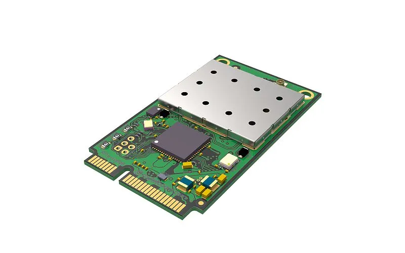

R11e-LR8 - LR mPCIe Gateway module. It can be integrated into a RouterBOARD product with mPCIe slot. Requires LR package installation to configure in RouterOS.

Specifications
Low power-consuming with mini PCIe interface, for long-distance data, transmit:
- Interface – Mini-PCIe;
- Temperature Operating -40 / +70;
- Supports Class A and C;
- Frequency - 863-870MHz (EU);
- RF Output power - 862-870MHz (EU) @ 14dBm;
- Receive max sensitivity - 137 dB @ SF12, Depends on the antenna used;
- Maximum power consumption 2 W.
