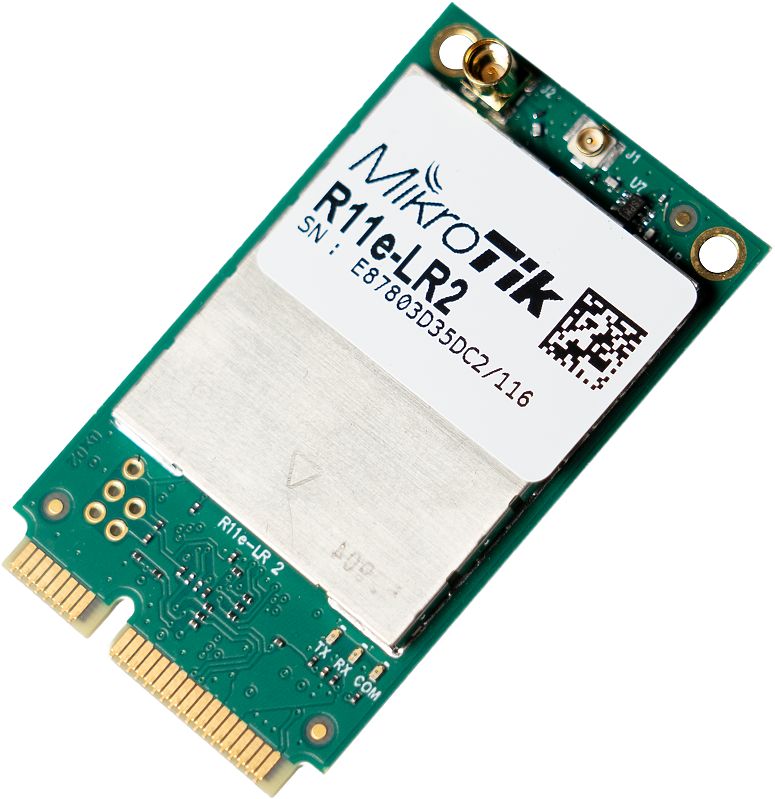

R11e-LR2 - LR mPCIe Gateway module. It can be integrated into a RouterBOARD product with mPCIe slot. Requires LR package installation to configure in RouterOS.

  • The card can be installed in your desired device using the factory provided screw holes in a PCB plate; Pictures added for illustration purposes, the device configuration, and the placement of the miniPCIe card may vary.
  • Locate miniPCIe slot on your device;
  • Unscrew two factory attached screws;
  • Install the module to the miniPCIe slot and secure it with previously removed screws. Tightening torque 0,3 Nm.

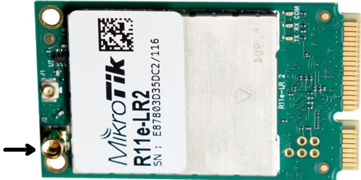

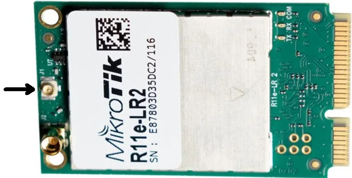

You can use UFL or MMCX connectors.
If your device does not have internal antennas, it is possible to connect to the external antennas by adding cable connectors, product code — ACSMAUFL. Please connect and disconnect the antenna, when the device is turned off!
We recommend using TOF-2400-8V-4 Omni antenna
When using UFL connector, attach the antenna cable to the connector shown below:
When using MMCX connector, attach the antenna cable to the connector shown below:
After you attach the antenna, you can turn the device on. Make sure that the right connector is used by the module in the software settings.
