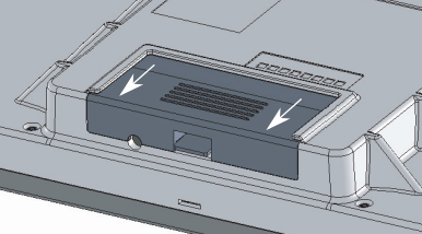

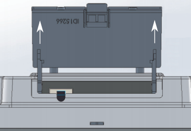

Opening latch​
To access the Ethernet port and reset button, please open latch:
  • Pull the latch out downwards from the device.
  • Lift the latch, but do not remove them completely.

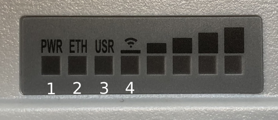

Front status LED behavior​
RouterOS allows configuring each LED's activity the way that the user wishes. It is possible to configure the LEDs to display wireless strength, blink the LEDs on interface traffic activity, and many other options. For further information please visit the LEDs manual page. Default factory configuration for this device:
  • Solid Blue – The device is powered on.
  • Solid Green – Connected Ethernet port.
  • Solid Green – User-defined LED.
  • Solid Green – The set of five green LEDs, shows the signal strength.

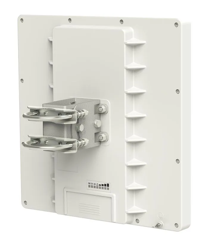

The device is designed to be used outdoors and mounted on the mast with all needed cables connecting through the latch of the unit.
Mounting and configuration of this device should be done by a qualified person.
When mounting on the mast, please ensure that the cable feed is pointing downwards. The IP rating scale of this device is IP54. We recommend using Cat5/6 shielded cables. Warning! This equipment should be installed and operated with a minimum distance of 30 cm between the device and your body. Operation of this equipment in the residential environment could cause radio interference. The QRT box contains several parts that need to be assembled. Please follow this process:

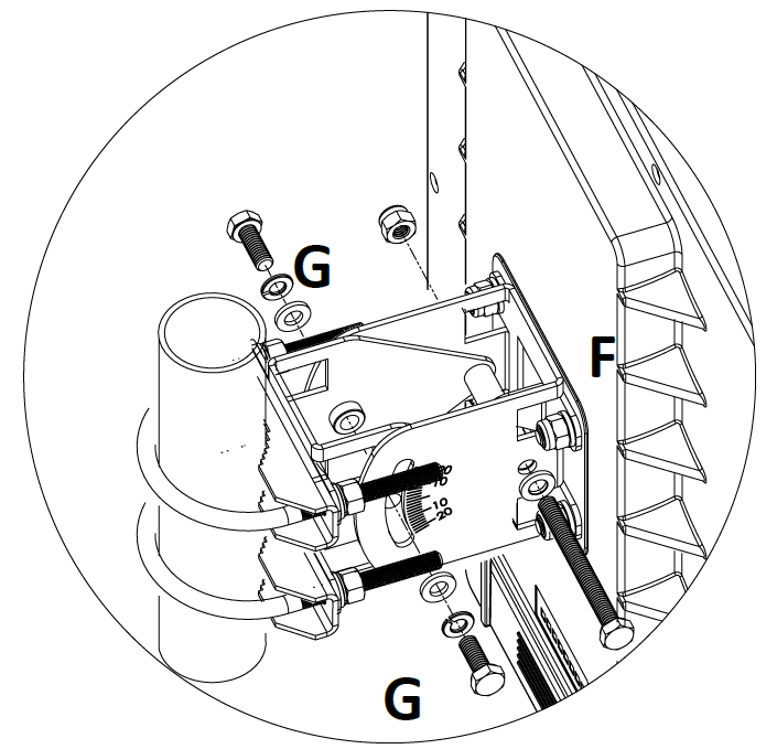

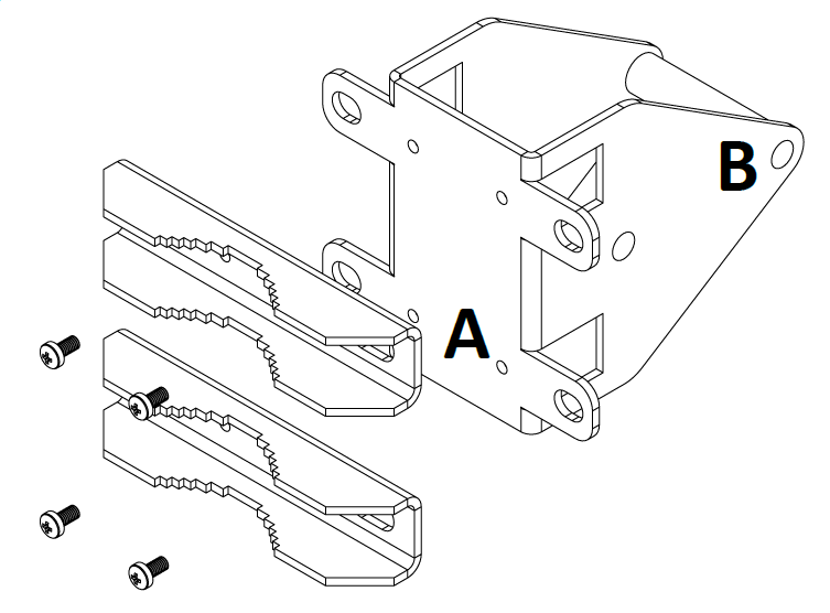

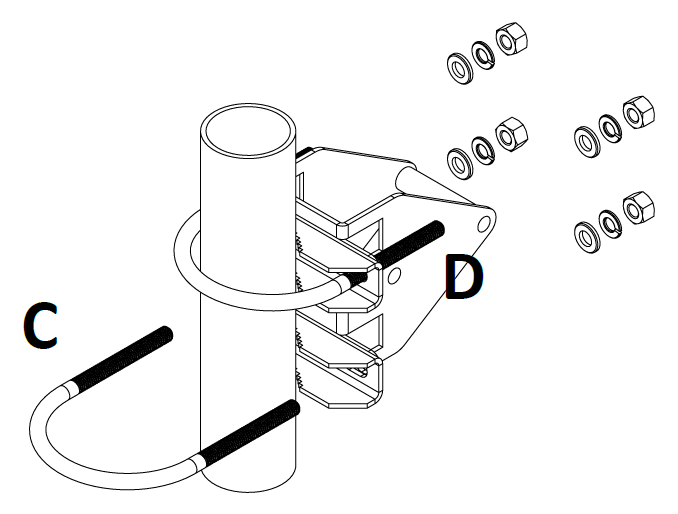

  • Attach the two brackets (A) to the swivel adjuster (B), by using the four provided screws (use a PH1 screwdriver).
  • Place the two U-bolts (C) around the mast or pole, and guide them through the holes on the swivel adjuster (D). Then, tighten the U-bolts, each with one regular washer, one spring washer, and one nut, as shown in the image to the right. All nuts need to be tightened using a size 10 (3/8 in) wrench. Maximum diameter of the pole can be up to 70 mm.

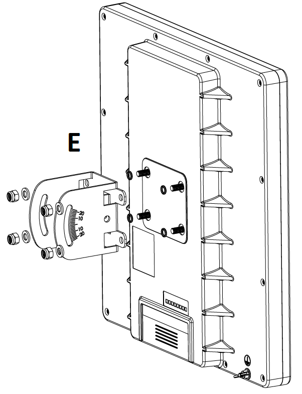

  • Use the mounting bracket (E), and put it on to the back of the antenna. Install with one rubber ring, one washer, and one nut for each of the built-in bolts (in that order).
  • Attach the swivel adjuster to the mounting bracket. Use the long bolt in the position (F). Put one regular washer, and one spring washer onto the shorter screws, then put them in positions (G). Do not tighten too much, as you need to adjust the antenna now.
  • Once antenna level and angle are adjusted according to the wireless signal in software, tighten all nuts. Note the degrees of angle for future reference. Wind load16 kg @ 40m/s, 9kg @ 30 m/s;

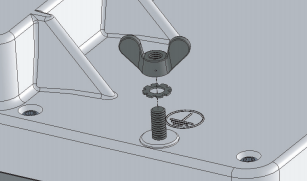

The installation infrastructure (towers and masts), as well as the router itself, must be properly grounded. The device includes a grounding wire attachment screw on the backside of the unit. Attach your grounding wire to the grounding screw, then attach the other end of the grounding wire to the grounded mast, please see the picture:
