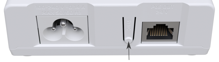

PWR connection button (sync)​
  • Hold 0.5 – 3 seconds. For 120 seconds will try to communicate with another PWR-LINE PRO device. A blinking amber LED light indicates that it is in search mode. You have to also do the same on the other PWR device, so they can synchronize. Press button again to cancel the search.
  • Hold 5 – 8 seconds. A new security key is generated. This is needed to remove a PWR-LINE PRO device from an existing PWR network.
  • Hold 10 – 15 seconds. Resets all PWR related settings.
  • In case of trouble to pair device, hold the SYNC button for 5 - 8 seconds to generate new network key and then re-attempt to pair it in PWR-LINE PRO network again holding SYNC button for 0.5 – 3 seconds.

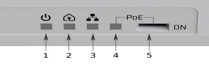

LED lights and PoE switch​
  • Blue LED indicates device power ON state.
  • Amber LED indicates that the device is paired, blinking amber indicated that the device is in search mode. It can be activated with a sync button. Please refer to the section.
  • Green LED indicates Ethernet port connectivity.
  • Red LED indicates that PoE is active.
  • PoE switch default position is OFF. A standard ballpoint pen can be used to switch positions. The Red light will indicate that PoE is active.
