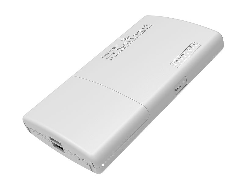

The PowerBox is an outdoor device with five Gigabit Ethernet ports that supporting PoE power output to ports 2-5 (1 A maximum per port, 2 A total maximum). See the PowerBox Pro product page for full specifications and brochures.

It is possible to attach the device to a DIN rail, using provided DIN rail bracket and screws. Since the device has a weatherproof outdoor case, you can mount it on a pole, with provided two zip ties or a steel clamp. The ground cable needs to be attached to a specially designed screw on the backside of the unit.
Please make sure to mount the device with the Ethernet ports facing down.
