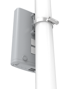

It is possible to attach the device to a DIN rail, using provided DIN rail bracket and screws. Since the device has a weatherproof outdoor case, you can mount it on a pole, with a provided steel clamp.
Please make sure to mount the device with the Ethernet ports facing down.
