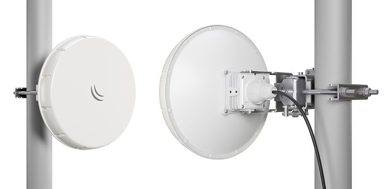

Mounting​
The device is designed to be used outdoors and mounted on the pole. When mounting, please ensure that the drain hole is pointing downwards. The IP rating scale of this device is IP54. We recommend using Cat6 shielded cables. Warning! This equipment should be installed and operated with a minimum distance of 60 cm between the device and your body. The operation of this equipment in the residential environment could cause radio interference. The mounting and configuration of this device should be done by a qualified person.

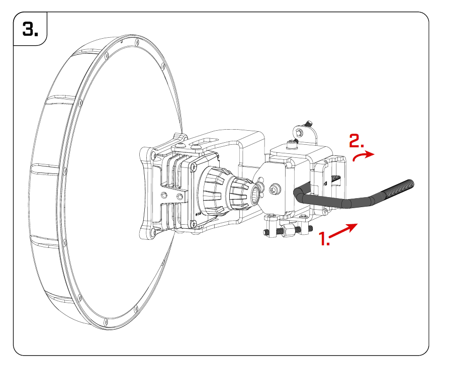

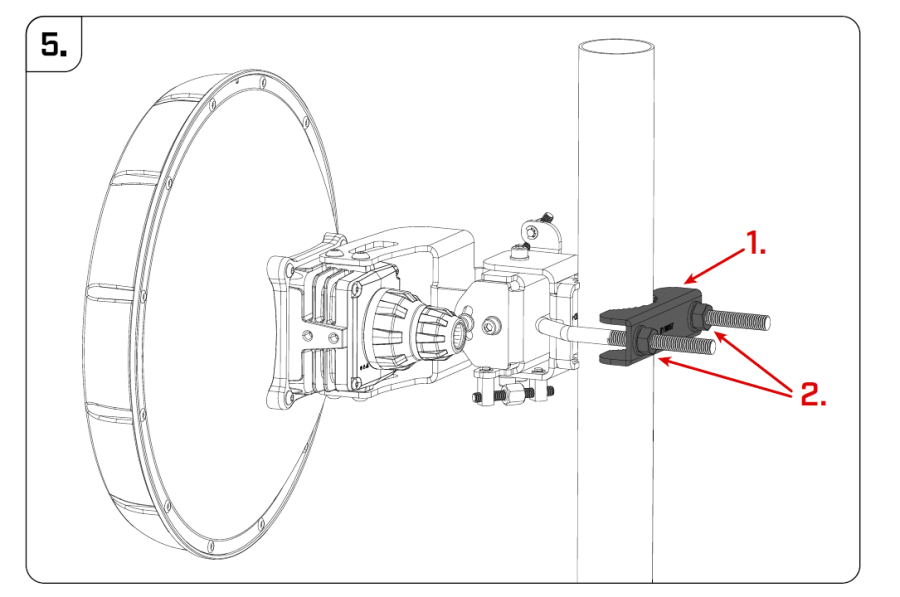

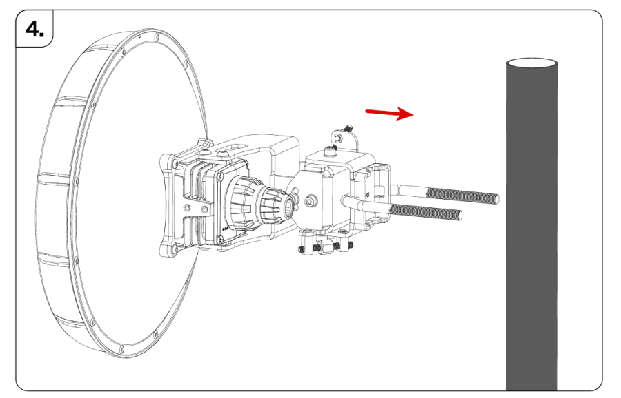

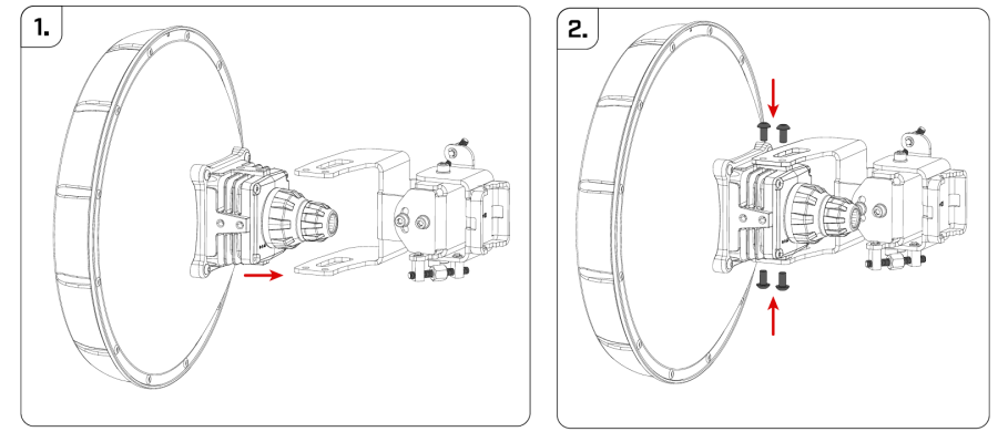

  • Assemble the device with a mounting bracket.
  • Use M5 screws to fix the mounting bracket, tighten it with the HEX3 tool - not provided in the package.
  • Insert U bolt. In the sequence as it is shown in the picture.
  • Attach the assembly to the pole.
  • Add mount bracket and use two 13 mm nuts to secure the device.

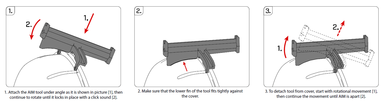

Aim tool usage​
The device has led arrows on the back of the unit. Use the arrows to reach precise alignment.
The arrows will light up and show the direction where to turn the unit. The goal is to reach the 0.4 - 0.8 degree range, where the signal is at its peak.
