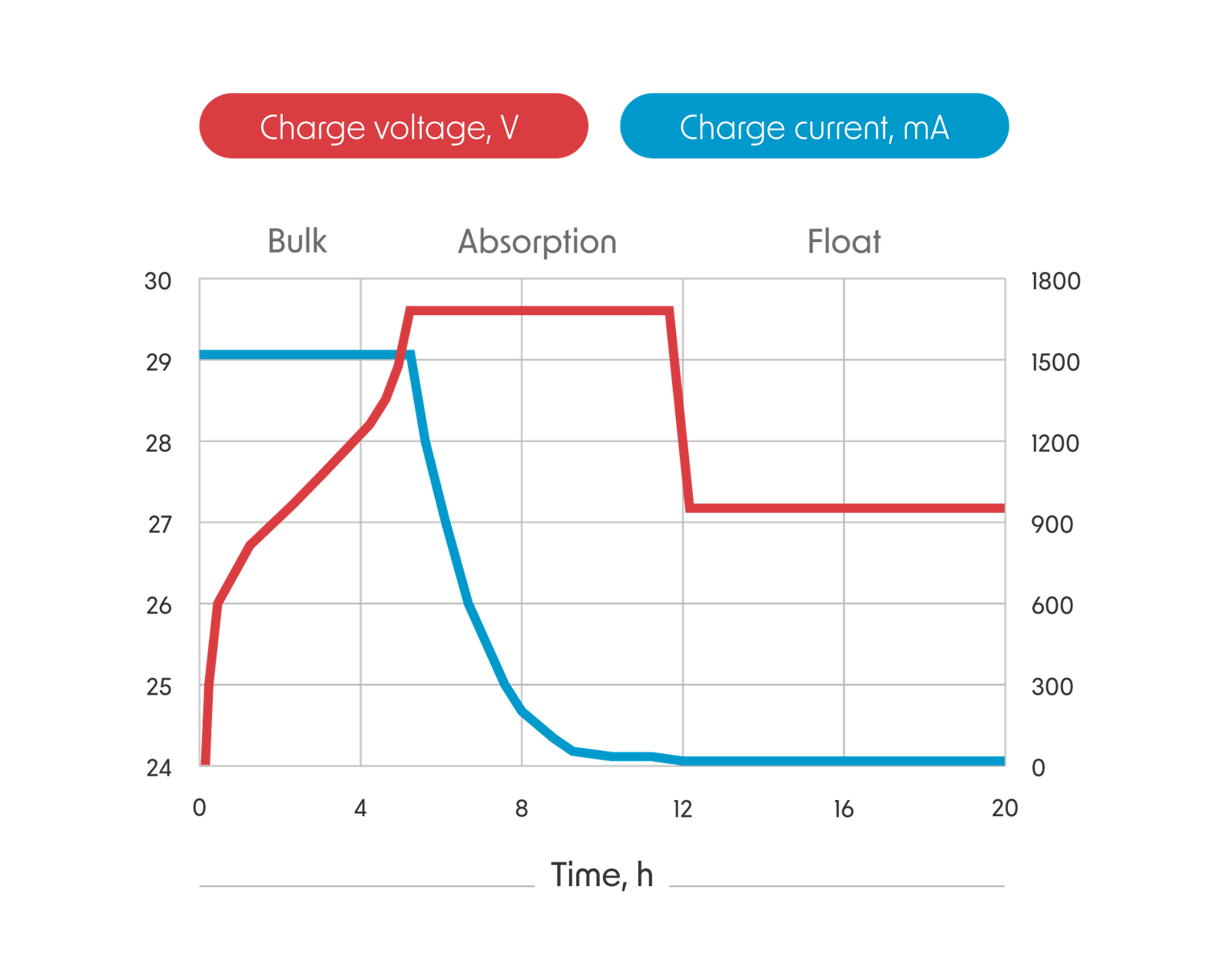

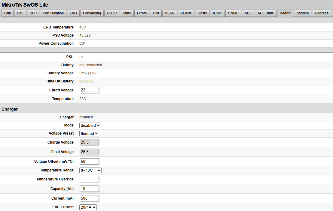

Battery Charger Parameters​
The battery charger is configured under the SwOS Lite Health tab. The charger operates in 3 steps- the bulk, absorption and float phases, which are configured by the charger parameters.
Voltage Preset allows for the selection of pre-defined float and charge voltages for the 4 relevant battery chemistries or, optionally, setting custom thresholds for the Charge and Float voltages.
The Current (mA) field allows setting the current at which the battery is charged during the bulk phase. During this phase, the battery voltage rises.
The Charge Voltageis the voltage at which the constant voltage is held in the absorption phase. During this phase, the battery current starts to decrease.
The EoC Current(End of Charge current) is the current at which the battery charger exits absorption and enters the float phase, relaxing to the float voltage.
The Float Voltage is the voltage at which the battery is held for some time, depending on the charger mode.
The EoC Current parameter values depend on the battery Capacity (Ah).
A 0.05C EoC Current value corresponds to a current that would charge the given battery capacity in 1/0.05C=20 hours. In other words, a 10Ah battery would have a 0.05C EoC current of 500mA.
There is a safety timer which will automatically enter the float phase if the battery has not finished the absorption phase in time. If the battery has not reached the EoC current in (Capacity/ Current)+30% minutes, the battery will end absorption and enter the float phase, if applicable.
As an example, a 10Ah capacity battery charged with a 1000mA charge Current setting will enter the float phase automatically in 780 minutes or 13 hours.
During the float phase, the charge current is limited to the EoC current + 20mA.The charger can be set to disabled or to one of three charging modes that impact the float behavior:
Standby2 · **Capacity (Ah)**hours and remains active until blocked or resetLead-acid batteries that are rarely cycled and must always be charged to their full capacity to be ready for a UPS application. The charge voltage is typically lower
Cyclic2 · **Capacity (Ah)**hours and remains disabled until reaching the self-discharge cutoffLead-acid batteries that are frequently cycled, but power is not available consistently, such as in a solar application. The charge voltage is slightly raised as there will not be time to fully float the battery
No-floatRemains disabled until reaching the self-discharge cutoff.Lithium batteries or other chemistries that are not meant to be float charged.
All three modes have the same absorption phase timeout. The self-discharge cutoff is 23.2V or the Cutoff Voltageparameter, **whichever is highest.**The Cutoff Voltage can be set to a maximum of 26V.
When re-enabling the charger, it can take up to a minute before charging starts. The battery current and voltage is displayed in the Health tab. In case the connected DC supply browns out or has fluctuating power, the charger might prevent charging with the unstable power status.
