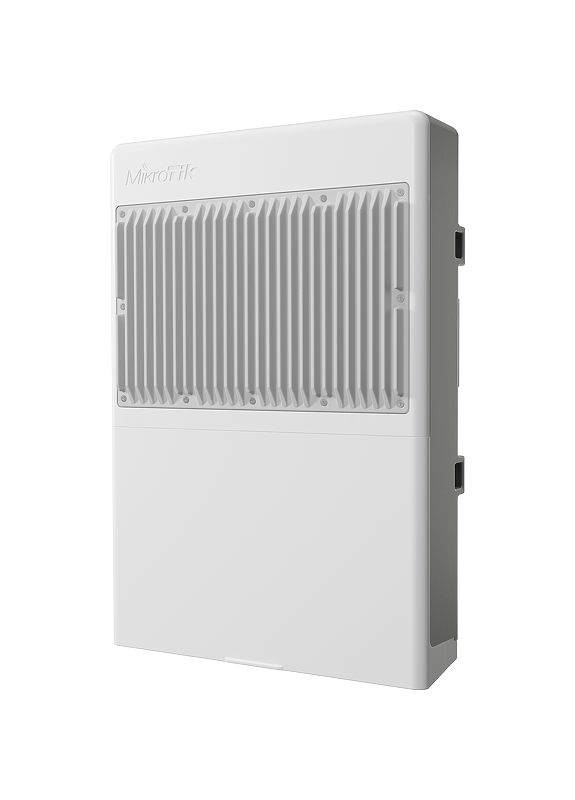

netPower 16P (CRS318-16P-2S+OUT)
The netPower is a weatherproof switch with the capability of delivering PoE to your connected devices. See the netPower 16P product page for full specifications and brochures.

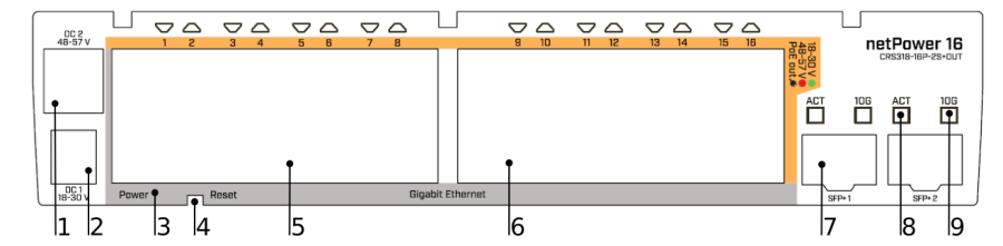

Extension slots and ports
  • DC power connector 48 – 57 V.
  • DC power connector 18 – 30 V.
  • LED indicating a power state of the device.
  • Reset button.
  • Gigabit Ethernet, 8 - ports, delivering PoE out.
  • Two - 10G SFP+ ports.
  • LED Indicating the activity of SFP port.
  • LED Indicating the speed of SFP port.

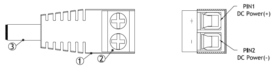

  • Direct-input power jack 2, 48-57 V DC ⎓. Use included DC plug to connect with your power source:
  • DC plug 2.1x5.5x12 mm to Screw Terminal 2pin.
  • Connect your power source cables to the two pins and secure them in place by tightening screws.
  • Connect DC plug to the device. The power consumption under maximum load can reach 21 W, with attachments 325 W.
