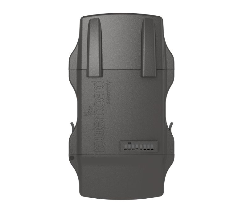

NetMetal 5 (RB922UAGS-5HPacD-NM)
The NetMetal is a solid and waterproof outdoor device. It has a high power wireless interface, and one Gigabit Ethernet connector, which supports MDI-X auto-detection. The device has two or three RP-SMA connectors for connecting external antennas (depends on model). The device is packaged with a 24 V power adapter, a PoE injector, and two mounting loops. There are four models available – two Three-chain devices (with miniPCIe slot and without), and two Dual-chain models (with miniPCIe slot and without). Extra places for more RP-SMA connectors are available on the unit in this case.

The NetMetal is designed to be used outdoors and mounted on pole or DIN rail.
When mounting, please ensure that the cable feed is pointing downwards. The IP rating scale of this device is IP66. We recommend using Cat6 shielded cables. Warning! This equipment should be installed and operated with a minimum distance of 20 cm between the device and your body. Operation of this equipment in the residential environment could cause radio interference.Mounting and configuration of this device should be done by a qualified person.The mounting hose clamp is provided with the package.
- Guide hose clamp through the opening on the back of the device.
- Attach to the pole or mast.
- Align and secure by hose clamp screw using HEX3 screwdriver.
- The device should be always placed by TOP cover facing upwards.
- When mounting on the DIN rail, please find a special bracket in the package and secure it with four screws to the back of the unit.
- With the attached mounting bracket you will be able to slide the device on the DIN rail.
