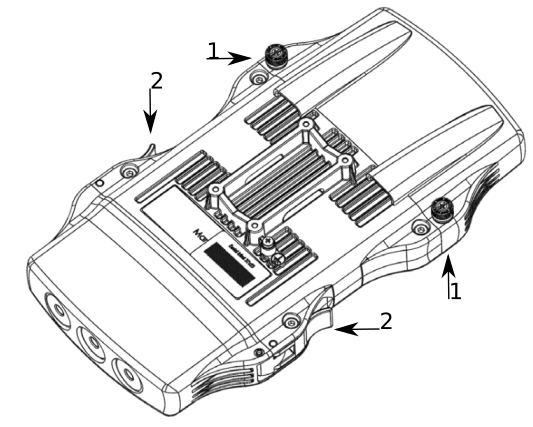

Removing upper and bottom covers​
  • To remove the upper cover, unscrew two captive screws and slide it off the main body. Do not remove screws completely, when assembling tightening torque 0.2 Nm.
  • To remove the bottom cover, release clips for both fasteners and cover will be free to open.

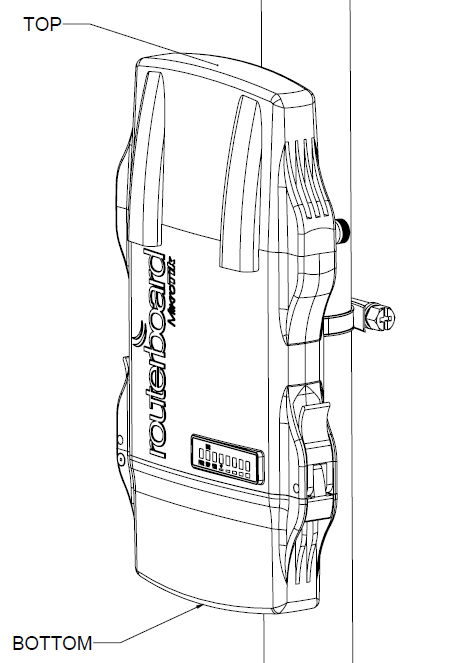

Mounting​
The NetMetal ax is designed to be used outdoors and mounted on pole or DIN rail.
When mounting, please ensure that cable feed is pointing downwards. The IP rating scale of this device is IP66. We recommend using Cat6 shielded cables. Warning! This equipment should be installed and operated with a minimum distance of 20 cm between the device and your body. Operation of this equipment in the residential environment could cause radio interference. Mounting and configuration of this device should be done by a qualified person. The mounting hose clamp is provided with the package.
  • Guide hose clamp through the opening on the back of the device.
  • Attach to the pole or mast.
  • Align and secure by hose clamp screw using PH2 screwdriver.
  • The device should be always placed by TOP cover facing upwards.
  • When mounting on DIN rail, please find a special bracket in the package and secure it with four screws to the back of the unit.
  • With the attached mounting bracket you will be able to slide the device on the DIN rail.

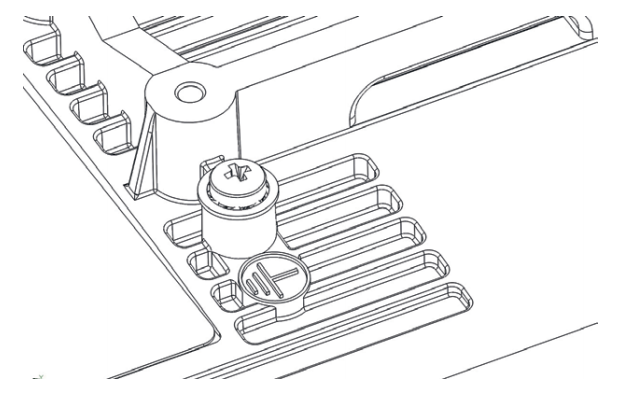

Grounding​
The installation infrastructure (towers and masts), as well as the router itself, must be properly grounded. The device includes a grounding wire attachment screw. Attach your grounding wire to the grounding screw, then attach the other end of the grounding wire to the grounded mast.
Please secure all loose Ethernet cables and antenna cables to the pole or mast approximately 30cm from the device, so that the cable weight is not pulling the ports and connectors.

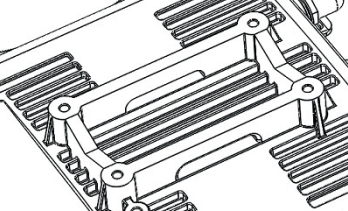

MiniPCIe slot usage​
This NetMetal ax version does not have a modem installed. To install the module you will need to remove the upper cover and open bottom cover (see Removing upper and bottom covers). Installing a miniPCIe module should be done by a qualified person, please follow safety precautions when handling electrical equipment:
  • Use a wrist grounding strap when unpacking and working with electrical components to avoid electrical discharge (ESD) damage.
  • Use a screwdriver to remove the four screws.
  • Remove the top cover by lifting it.
  • Locate the miniPCIe slot on the PCB and remove two factory attached screws.
  • Attach provided a thick thermal pad to the card, and install the card into miniPCIe slot so that the thermal pad is between PCB and card.
  • Secure the card in place using previously removed two screws.
  • Attach the grey uFL connector to the MAIN antenna connector of the modem, attach the black cable to the secondary (or AUX) connector.
  • Attach a thinner thermal pad to the top of the card.
  • Drill holes for SMA connectors.
  • Guide through the card cables.
  • Reassemble.
When assembling make sure the rubber sealing is placed firmly around the case for equal spread to prevent water contamination. Case screw torque 2,5 Nm. When mounting the antenna for the installed card, please make sure to keep them separate at a good distance from Wireless antennas.
