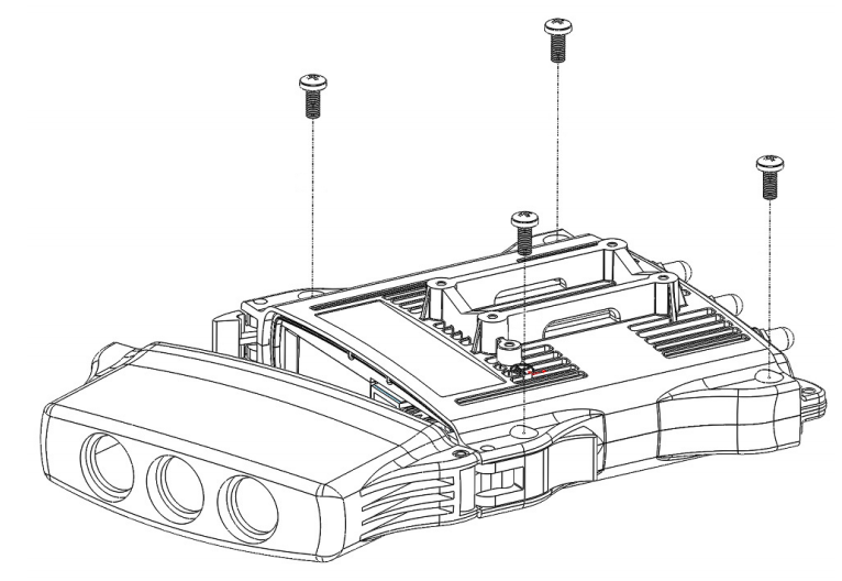

MiniPCIe slot usage​
This NetMetal version is without modem installed. To install the module you will need to remove the upper cover and open the bottom cover. Installing a miniPCIe module should be done by a qualified person, please follow safety precautions when handling electrical equipment:
  1. Use a wrist grounding strap when unpacking and working with electrical components to avoid electrical discharge (ESD) damage.
  2. Remove four screws using the HEX3 screwdriver.
  1. Remove the top cover by lifting it.

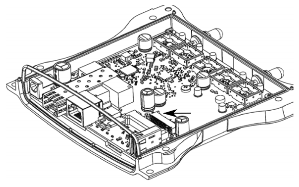

  2. Locate the miniPCIe slot on the PCB and remove two factory attached screws.
  1. Attach provided a thick thermal pad to the card, and install the card into miniPCIe slot so that the thermal pad is between PCB and card.
  2. Secure the card in place using previously removed two screws.
  3. Attach the grey uFL connector to the MAIN antenna connector of the modem, attach the black cable to the secondary (or AUX) connector.
  4. Attach a thinner thermal pad to the top of the card.

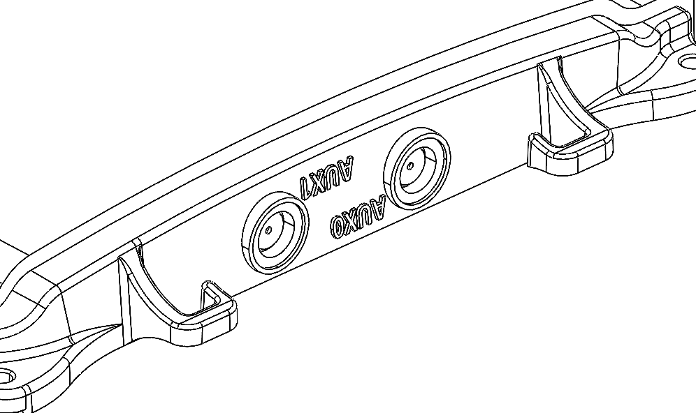

  1. Drill holes for SMA connectors.
  2. Guide through the card cables.
  3. Reassemble.
