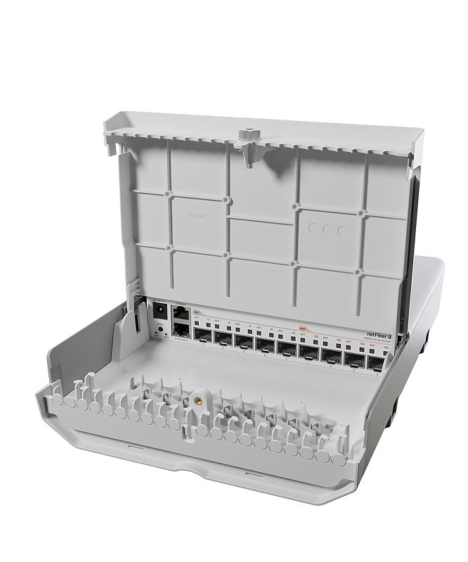

Extension slots and ports
- DC power connector 18 – 57 V.
- LED indicating a power state of the device.
- A number of 1G SFP ports - 5.
- A number of 10G SFP+ ports - 4.
- Reset button.

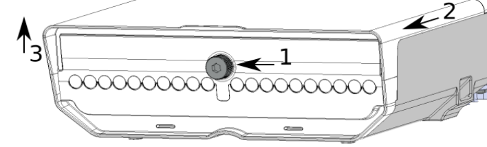

Bottom Lid
- The bottom lid is secured in place with the captive screw, it can be unscrewed by hand, but do not remove the screw completely.
- Pull the cover towards.
- Lift to access Ethernet ports.

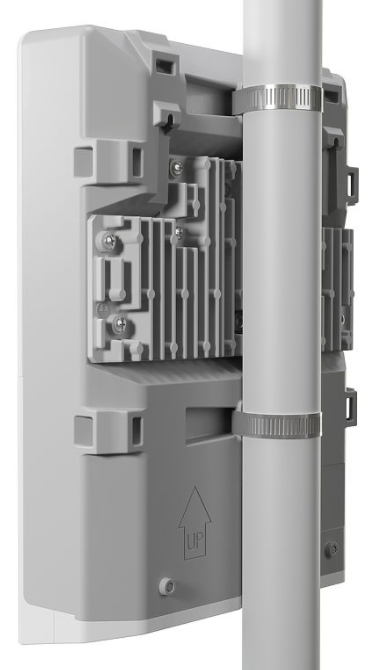

The device can be mounted in several ways: pole, wall, or ceiling. The package also includes a drill hole template with detailed mounting instructions, to help you with the drill hole marking. The device has eight mounting points for versatility use zip ties or steel clamps for mounting on the pole.
The IP rating scale for this device is IP54. When mounting outdoors, please ensure that any cable openings are directed downwards.
Mounting points:
- There are eight mounting points on the back of this device. Choose the most relevant ones.
- Middle points are designed for mounting on the mast, there are curves on the case for slim fitment. It's recommended to secure an Ethernet cable to the pole using zip ties. With the distance from the device approximately 30 cm.
The device must be mounted by an UP arrow facing upwards.
The installation infrastructure (towers and masts), as well as the router itself, must be properly grounded. The device includes a grounding wire attachment screw on the backside.
- Attach your grounding wire to the grounding screw.
- Attach the other end of the grounding wire to the grounded mast. The mounting and configuration of this device should be performed by a qualified person. Mounting on the mast or pole:
Insert provided steel clamps into mounting spots.
Attach the unit to the mast.
Align the device and secure it by tightening steel clamps with a PH2 screwdriver.
Guide Ethernet cables through the opening, connect to the Ethernet ports.
Close bottom latch and secure with a screw. A – Always make sure to place the unit in an upwards position. B - It's recommended to use electrical tape to increase friction between materials. Mounting unit on the wall:
