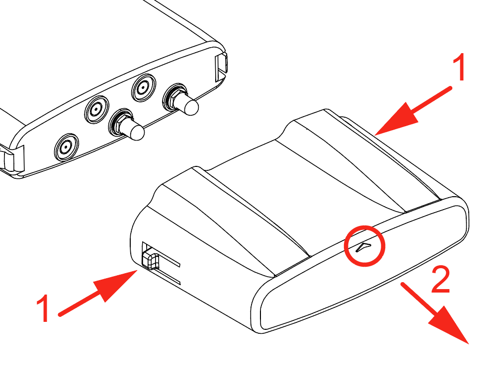

Removing upper cover​
  • To remove the upper cover, press both side clips.
  • Pull cover to the side while holding the body. When assembling please not mark on the top cover or reference.

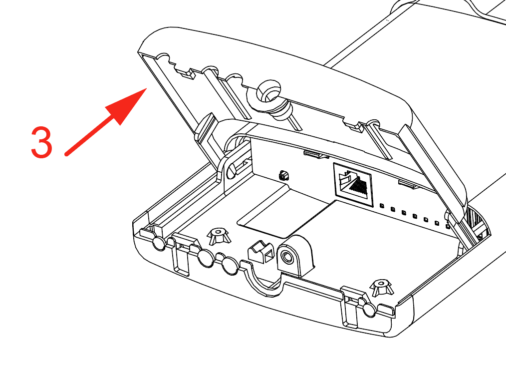

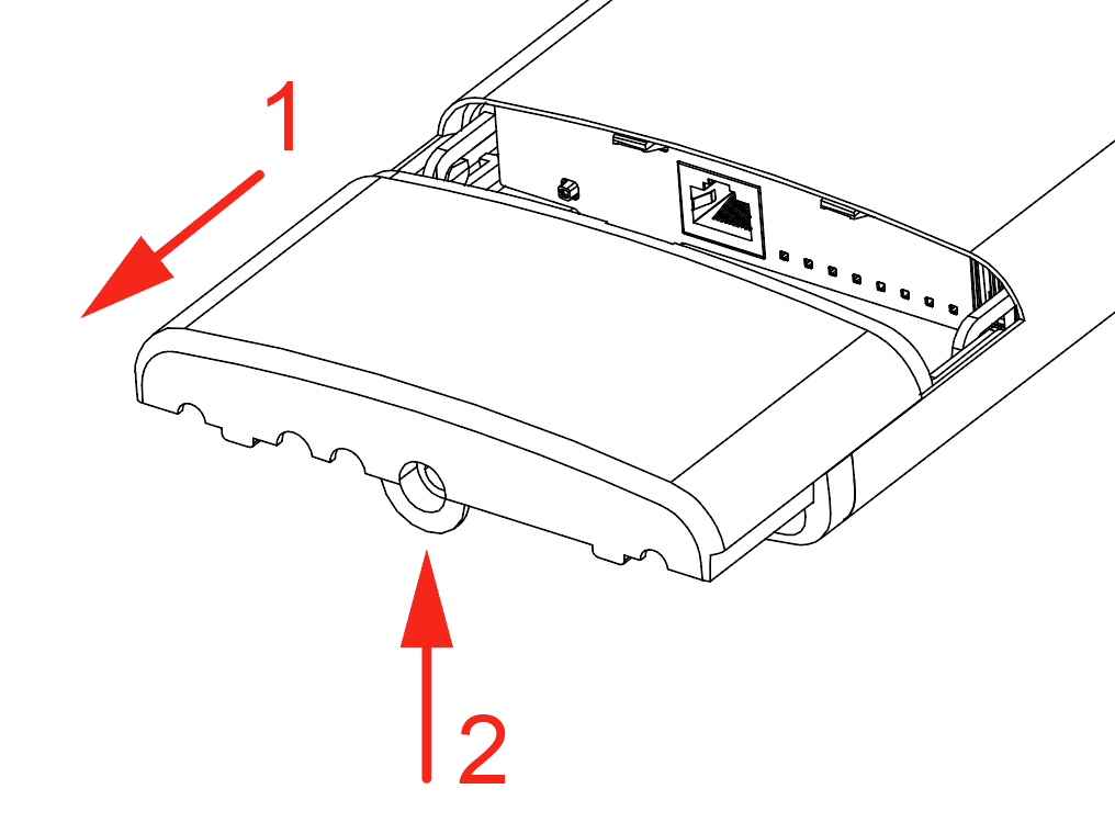

Opening bottom cover​
  • To open the bottom cover, unscrew the locking screw.
  • Pull cover slightly from the device body.
  • Lift it, but do not remove it completely.

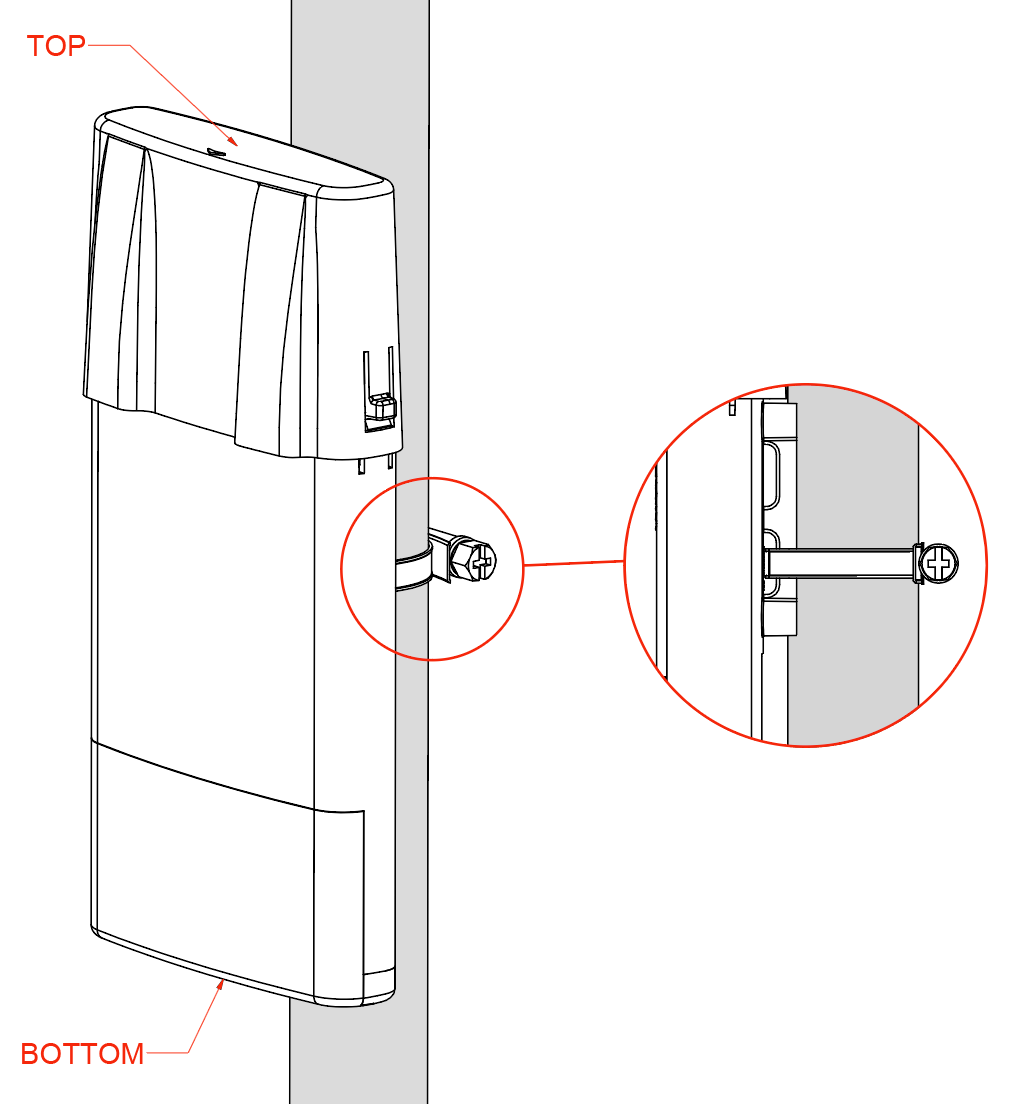

Mounting​
The NetBox 5 ax is designed to be used outdoors and mounted on a pole or DIN rail.When mounting, please ensure that the cable feed is pointing downwards. The IP rating scale of this device is IP54. We recommend using Cat6 shielded cables. Warning! This equipment should be installed and operated with a minimum distance of 240 cm between the device and your body. The operation of this equipment in the residential environment could cause radio interference. Mounting and configuration of this device should be done by a qualified person.
Mounting on the pole​
The Mounting hose clamp is provided with the package.
  • Guide hose clamp through the opening on the back of the device and attach it to the mast.
  • Align and secure with hose clamp screw using PH2 screwdriver.
  • The device should be always placed by TOP cover facing upwards.
  • Connect your antenna.
  • The antenna is no provided with the device only for illustration purposes.

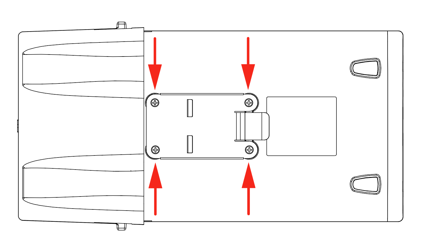

Mounting using DIN rail​
When mounting on the DIN rail, please find a special bracket in the package and secure it with four screws to the back of the unit. With the attached mounting bracket you will be able to slide the device on the DIN rail.

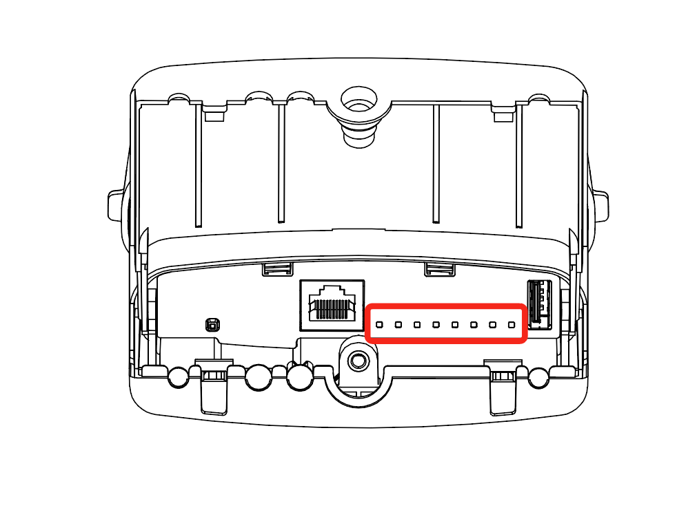

Front status LED behavior​
The LEDs are located under the bottom cover.
RouterOS allows configuring each LED's activity the way that the user wishes. It is possible to configure the LEDs to display wireless strength, blink the LEDs on interface traffic activity and many other options. See the LEDs page for further information. Default factory configuration for this device:
  • Solid Blue – The device is powered on.
  • Solid Green – Indicates the device's state while powering it up into different modes, such as resetting the configuration or booting device for the Netinstall utility.
  • Solid Green – Active Ethernet port.
  • 4-8 Solid Green – The set of five green LEDs, shows the signal strength.
